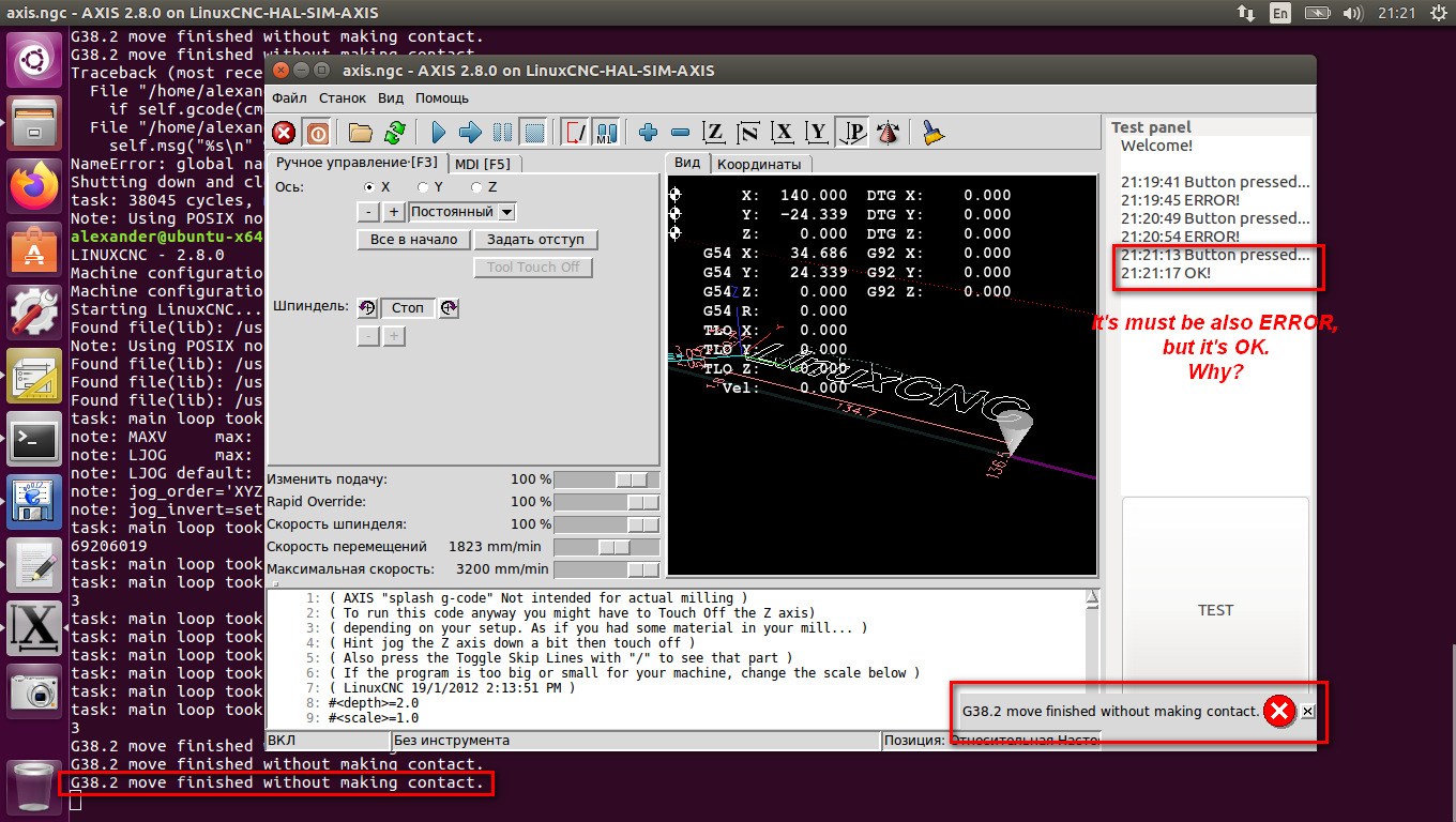

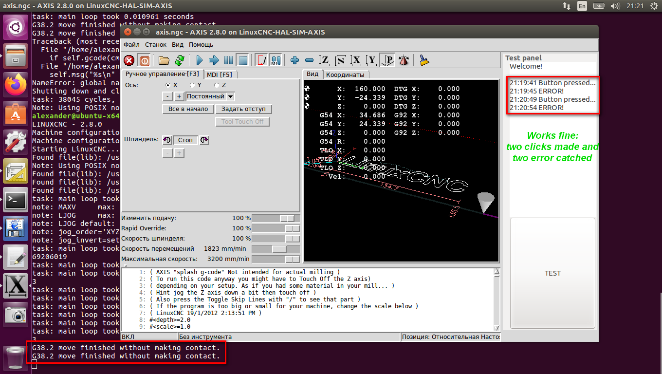

I trying to catch errors during executing G38.2 and sometime it works fine, but sometimes not... Please point me what I'm doing wrong.
I have a simple GladeVCP panel with a button and textview component, python code is below.
Few times my code works fine, errors during G38.2 catching correctly:
But sometime it finished with OK, but it should not:
I think the problem is in error_poll() function, but I have no idea what I have missed. Hope for your help, guys.

Replied by cmorley on topic GladeVCP + Python: error handling during G38.2
Error handling like this will not be reliable.
Linuxcnc can only send error messages to one reader.
it's a race condition on who gets it.
In qtvcp we worked around this by having qtvcp read the error then send that to all other registered listeners (using STATUS messages)
You would need to tap into AXIS's error handling some how and send a message to gladevcp (like maybe x11 client messages as AXIS slready has this capability) to do this.
it's not impossible but I'm not an AXIS expert.
Chris

Hi Chris,
Thanks a lot for your reply, I have to think about it. Also I found another way (probably), I will try to get global parameter #5070 (G38 probe result) from my python code, maybe this will be best solution for me.

It looks like I found pretty simple and worked solution, the modified part of my source code is below:
# Line by line G-Code execution
def gcode(self, s):
for l in s.split("\n"):
self.command.mdi(l)
# Default wait_complete() timeout is 5 seconds,
# so 30 seconds should be enough for slow G38 operations
self.command.wait_complete(30)
#if self.error_poll() == -1:
# return -1
return 0
# On button click
def on_button_clicked(self, widget, data = None):
self.msg("Button pressed...");
# Set MDI mode
self.set_mdi_mode()
# A simple G-Code
cmd = """G91
G38.2 X-20 F300
G90"""
# Executing G-Code
self.gcode(cmd)
# Check probe status
self.stat.poll()
if self.stat.probe_tripped == False:
self.msg("ERROR!")
else:
self.msg("OK!")
# Set manual mode
self.set_manual_mode()
