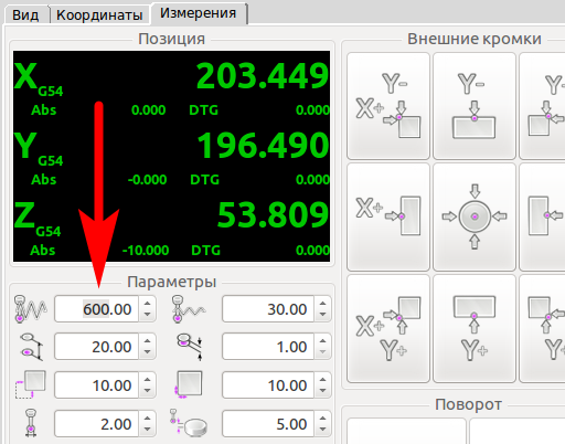

Hi everyone,
Is it possible to change the color of selected text in HAL_SpinButton? By default it's light-light-gray, and it's really hard to see is anything selected or not. I didn't find any color's options in the Glade editor.

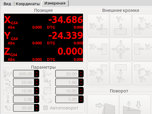

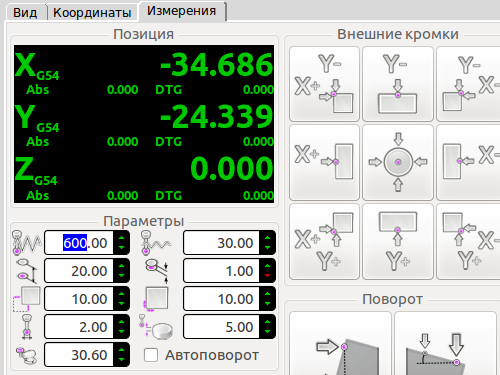

Finally solved! :woohoo:
#!/usr/bin/env python
# -*- coding: utf-8 -*-
import os
import gtk
import linuxcnc
    def __init__(self, halcomp, builder, useropts):
        self.builder = builder
        spinbtn = self.builder.get_object('spinbutton1')
        # Border
        spinbtn.modify_bg(gtk.STATE_NORMAL, gtk.gdk.color_parse("black"))
        spinbtn.modify_bg(gtk.STATE_INSENSITIVE, gtk.gdk.color_parse("black"))
        # Up/down arrows
        spinbtn.modify_fg(gtk.STATE_NORMAL, gtk.gdk.color_parse("#00ff00"))
        spinbtn.modify_fg(gtk.STATE_INSENSITIVE, gtk.gdk.color_parse("red"))
        # Selected text background
        spinbtn.modify_base(gtk.STATE_ACTIVE, gtk.gdk.color_parse("blue"))
        # Selected text
        spinbtn.modify_text(gtk.STATE_ACTIVE, gtk.gdk.color_parse("white"))
def get_handlers(halcomp, builder, useropts):
    return [HandlerClass(halcomp, builder, useropts)]
