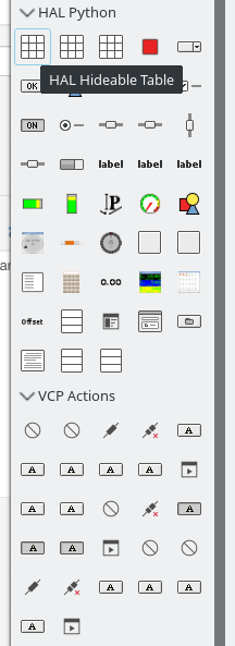

The docs say to try using HAL_Box, and the examples use it, but I can't find the widget in the editor. I do have other HAL Python widgets:
Is that obsolete, or is my installation missing something?

HAL_HBox is depreciated use HAL_Table.
