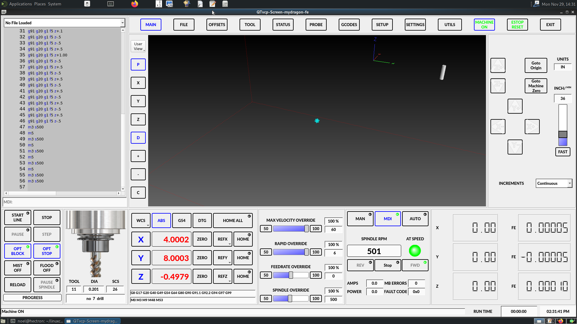

well, getting my qtdragon going.... joint velocity and following error display is cool.
problem with the jog velocity slider.....it's TOOOOO narrow.
I there a way to make the graghic wider? I've stretched it in qtdesigner, but the slot and little rectangle don't change size.
That's what I would like to make wider and larger. Been looking through all the docs in linuxcnc and in QtDesigner/Qt-5.
Can't find a thing...
little help please, if it's possible.... hopefully in the .qss file.

Replied by cmorley on topic GladeVCP widget customization.................
You should post in the Qtvcp topic - you are not using Gladevcp.
styling the slider:
doc.qt.io/qt-5/stylesheet-examples.html#customizing-qslider
You might check if the maximuimSize horizontal/vertical has been set
styling the slider:

ok, found it.... gotta connect mydragon-fe.led_at_speed to spindle.0.speed-in
works now..
I run the actual spindle speed through a 'lowpass' comp to smooth it a bit,
then through a 'near' comp to get the actual 'at-speed' signal to go to spindle.0.speed-in
make sense???
Is this also done somehow in dragon???
check out the velocity and following errors. lower right. also the wider jog speed slider, and larger at-speed led.....
of these mydragon gui specific hal pins, what else do I need to connect???
thanks.

If you use the stateLED you don't need to connect an at speed pin - qtvcp calculates it from the requested speed, override and actual speed.

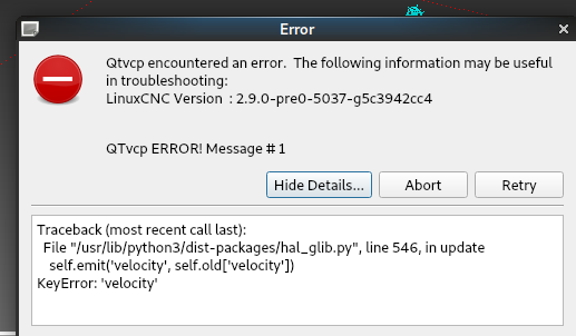

cmorley,well, i may have messed up. I did a system update, and linuxcnc, etc. got updated....now CRASH. something with my velocity display.
honestly, was working fine before the update....LIttle help please?
not sure if I need to revert, or even how to.....
progress i think.
i'm pretty sure it has to do with what I added to the hal_glib.py file to get the current joint velocities.just can't recall.
attached new files here.
this is hal_glib.py, .....(full file attached)
you added the following-error, I added the velocity. recall joint velocities are in the joint dictionary.
'following-error': (GObject.SignalFlags.RUN_FIRST , GObject.TYPE_NONE,(GObject.TYPE_PYOBJECT,)),
'velocity': (GObject.SignalFlags.RUN_FIRST , GObject.TYPE_NONE,(GObject.TYPE_PYOBJECT,)),
# ferror
self.emit('following-error', self.old)
# current velocity
self.emit('velocity', self.old)
this is my handler file.....(full file attached)
STATUS.connect('following-error', lambda w, data: self.updateFerrorDisplay(data))
STATUS.connect('velocity', lambda w, data: self.updateVeloDisplay(data))

AND what and where is the 'joint dictionary' and the 'python interface'? I want to peruse it....

- Posts: 7368
- Thank you received: 2181
03 Dec 2021 01:58 #228250
When you updated it over wrote the hal_glib.py file.
You will need to add back your edits.

03 Dec 2021 15:00 #228288
by Roguish
Replied by Roguish on topic GladeVCP widget customization.................
jmorley,
yup. figured that out. doh.
Would you please add a line or so to the hal_glib.py that makes joint velocity easily available. Same as you did with following error? Please.
I must have done that somehow, but cannot get it back, yet. A permanent code fix would be far better, and not as susceptible to brain fade.....
