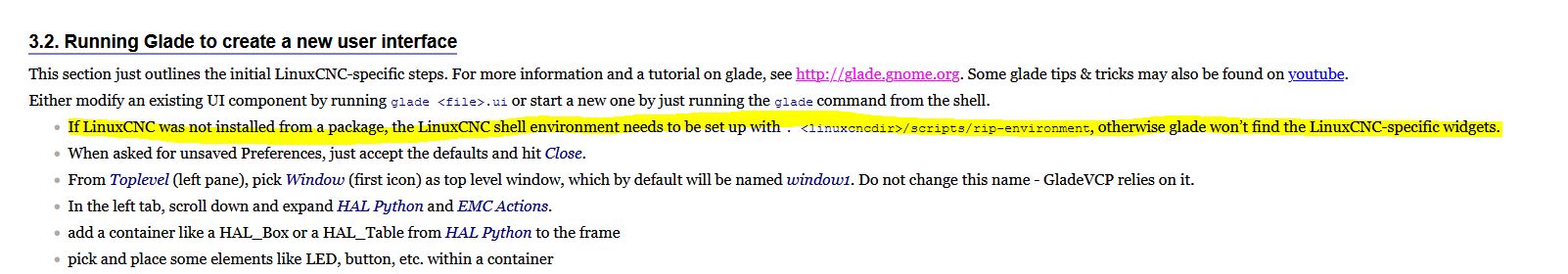

Trying to follow tutorials. But when loading sample ui's I cant see the widgets. Could someone point me in the right direction as how to set up the shell environment? I tried looking for the directory scripts/rip-environment but no luck.

The below only applies if you have built Linuxcnc from source.
Ok what some people leave off is the period (.)
Obviously yourusername & linuxcncsrcdir are particular to your machine. But what is important is the period(.) then space.
If you have Installed LinuxCNC from packages
If you’re using an installed version of LinuxCNC the examples shown below are in the configuration picker in the Sample Configurations > apps > gladevcp branch.
. /home/yourusername/linuxcncsrcdir/scripts/rip-environmentObviously yourusername & linuxcncsrcdir are particular to your machine. But what is important is the period(.) then space.
