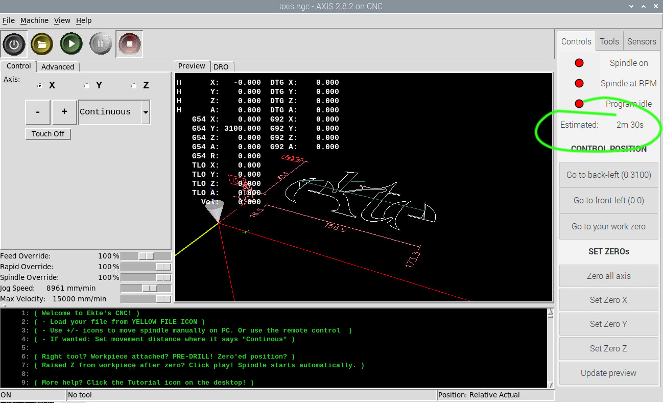

I wanted to show the estimated and running time for program in my gladevcp UI panel. Ignoring the fact that the estimated time may be off by quite a bit.
Given that there the "file->properties" dialogue in the Axis UI that shows the estimated time I wanted to expose the same calculated time to my gladevcp panel.
Since the gladevcp python file is in a seperate procesa and I could not find a way to access needed information through available python librares (linuxcnc, hal, halgui and so on) my slightly hacky workaround was to:
1. Use the USER_COMMAND_FILE that has access to Axis objects to interact with gcode-data and reuse the same code that populates the estimated time for "file-properties" panel
2. Monitor if a new file has been loaded through user_live_update() function. (I could not find anywhere to add an eventlistener...)
3. Write the estimated time for program to a temporary file when a new file has been loaded by Axis GUI
4. On the other side in my gladevcp python script - Listen to file changes through a gllib.timeout_add_seconds() function called every second
5. Load time estimate from temporary file in step 2
6. Display in my gladevcp
In my USER_COMMAND_FILE python file:In my gladevcp python file
This is a very rounad about way of doing it, but atleast I got what I wanted. Does anyone know of a easier way to do this?

Yes its nice to see it, even though it is accurate. We are many people at workshop that use CNC and it is good to be able to get a rough idea of timing.
In order to get the solution I am using to work you need to have python scripts set up for both axis and your pyvcp. do you have that already? They way I have done it is not elegant and requires some manual coding and not just using pins, so I think it is best if you have done a little bit of python?
