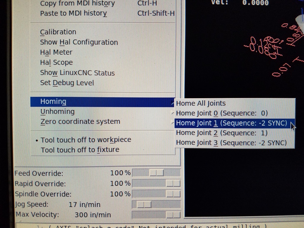

Now I'm curious what the Machine --> Homing --> Home Joint 1 (or Home Joint 3) items do command-wise when clicked. It seems like they would have to go into joint mode first and then back into world mode as the last thing they do. But what about in between? If you have joints with a linked home sequence, can you just call homing for one of them and it will automatically do both?
- Posts: 21980
- Thank you received: 7481
20 Feb 2022 16:18 #235393
Replied by tommylight on topic how to make GladeVCP button execute ordered lines of code?
Yes, if set correctly.If you have joints with a linked home sequence, can you just call homing for one of them and it will automatically do both?
