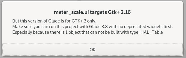

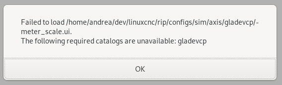

Update:
I installed glade 3.38, Gtk3 using Synaptic, I'm not Linux expert so.. every day a discovery!
It was really easy!!
Well.. now I have a couple of issues:
1. seems missing "gladevcp", the message opening a file present already in LinuxCNC:
2. Even I install all, maybe I can't edit something existing done with Gtk2, right?
