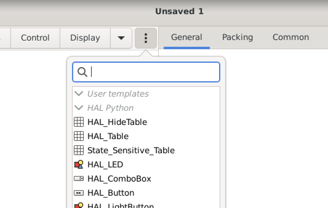

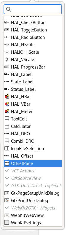

- HansU
- Posts: 730
- Thank you received: 217
14 Mar 2023 00:45 #266621
by HansU
Doing this gives me a part of the widgets, but those under VCP Actions etc. are missing:
Somewhere later on that VM I just noticed that I have all widgets available, just don't have any clue what caused this:
Adding an Extra Catalog does not have any effect for me.
Replied by HansU on topic how to copy glade3 to glade folder
1 - from a terminal with Glade NOT opened, run the following:sudo cp /usr/share/glade3/catalogs/hal_python.xml /usr/share/glade/catalogs/

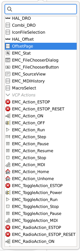

14 Mar 2023 20:49 #266702
by HansU
I figured out the reason.
The odd behavior is caused by Wayland (first picture). Switching to Xorg make those widgets appear magically
