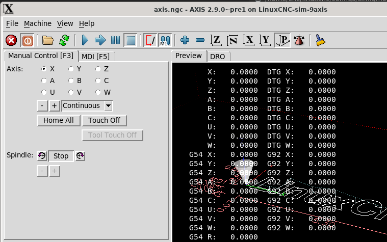

I have built a gantry router machine and I am using a tangential knife on the A axis. After turning the power off and on a few times the A axis starts loosing it's reference. Is there command I can put in the g code file that will rehome the A axis before the program starts? Or can I make a custom button that will rehome? Just need some guidance if it can be done.

To home the A axis I have to go to Machine/Homing/Home joint 4. I was hoping to make it a bit easier.

Thanks for the advice. On my axis main page pushing the Home All does home all my axiss (XYYZA) . I installed VOLATILE_HOME = ) in the A axis in the ini file to force me to rehome the A axis after I cycle power. It is nice to know that making a Glade button is possible but this is something I really need some help on.Any guidance would be welcome.
