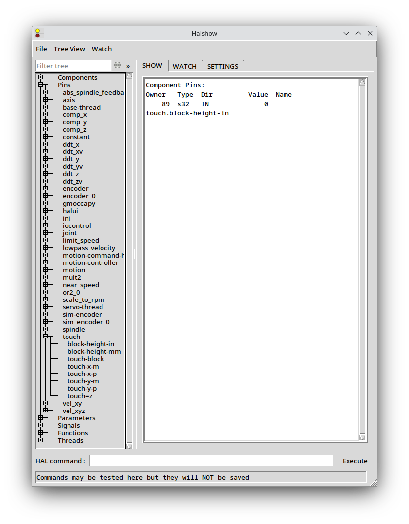

I am using linuxcnc-2.9.2. The machine was created with Bookworm PREEMPT-RT ISO. Then, linuxcnc was updated to 2.9.2
I also reproduced the problem bellow in my desktop with simulator. Version is 2.9.0~pre1+git20230208.f1270d6ed7
I am using gmoccapy
Relevant fragment of my INI file:
EMBED_TAB_NAME = Touch Piece
EMBED_TAB_COMMAND = gladevcp -x {XID} macros/touch.glade
EMBED_TAB_LOCATION = hbox_jog
I am trying to create a VCP panel.
I got to a point that I managed to make all buttons to work. But I would like to see some internal values displayed in the panel.
So. I setup a HAL_label, with ID=block-height-in. (Type is "1", i.e., accepts a float point)
The name of my glade file is touch.glade, so there should be a hal pin named touch.block-height-in
In my POSTGUI hal file, I have:
(Note that fragment bellow is for test purposes on the simulator. The real machine the constant.0.value is set by a M1xx script)
loadrt constant
addf constant.0 servo-thread
setp constant.0.value 3.000456
loadrt mult2
addf mult2.0 servo-thread
setp mult2.0.in0 25.4
net touch-block-in mult2.0.in1 <= constant.0.out
net touch-block-in touch.block-height-in <= constant.0.out
net touch-block-mm touch.block-height-mm <= mult2.0.out
This leads to the following error:
**** GMOCCAPY INFO : inifile = /home/edmar/linuxcnc/configs/sim.gmoccapy/gmoccapy.ini ****:
**** GMOCCAPY INFO : postgui halfile = ****:
gmoccapy_postgui.hal:36: Pin 'touch.block-height-in' does not exist

if I comment out the last 2 net lines, and start linuxcnc again, and use Halshow,
I can see the pin is there (see attachment)
Can someone explain what is happenning ?

01 Jan 2024 22:40 - 01 Jan 2024 22:40 #289515
by edmarwjr
Replied by edmarwjr on topic HAL pin is not created
Attachment here.

I found a solution for this problem. But I don't understand why it solves the problem.
I would appreciate if anyone could comment on that.
I Removed the last two lines from POSTGUI hal file (the net connections) and put them in a separate file (touch.hal)
Then replaced the EMBED_TAB_COMMAND with:
halcmd loadusr -Wn touch gladevcp -c touch -H touch.hal -x {XID} macros/touch.glade
The POSTGUI hal file is supposed to be executed after GUI is loaded, I understand that the gladevcp command line is part of the GUI, so net connections on POSTGUI should be fine.
Is it a race condition ?
TIA
Edmar

02 Jan 2024 06:53 #289535
Replied by cmorley on topic HAL pin is not created
Postgui only means after the GUI (Gmoccapy) is loaded.
Gladevcp is a separate program 'embedded' visually into gmoccapy, They are not in the same process context. Gladevcp can take longer to finish.
Meaning ya it can create a race condition.
Gladevcp HAL commands should be loadded in the gladevcp commamd line just as you did.
try:
EMBED_TAB_COMMAND = gladevcp -c touch -x {XID} -H touch.hal -x {XID} macros/touch.glade
try:
