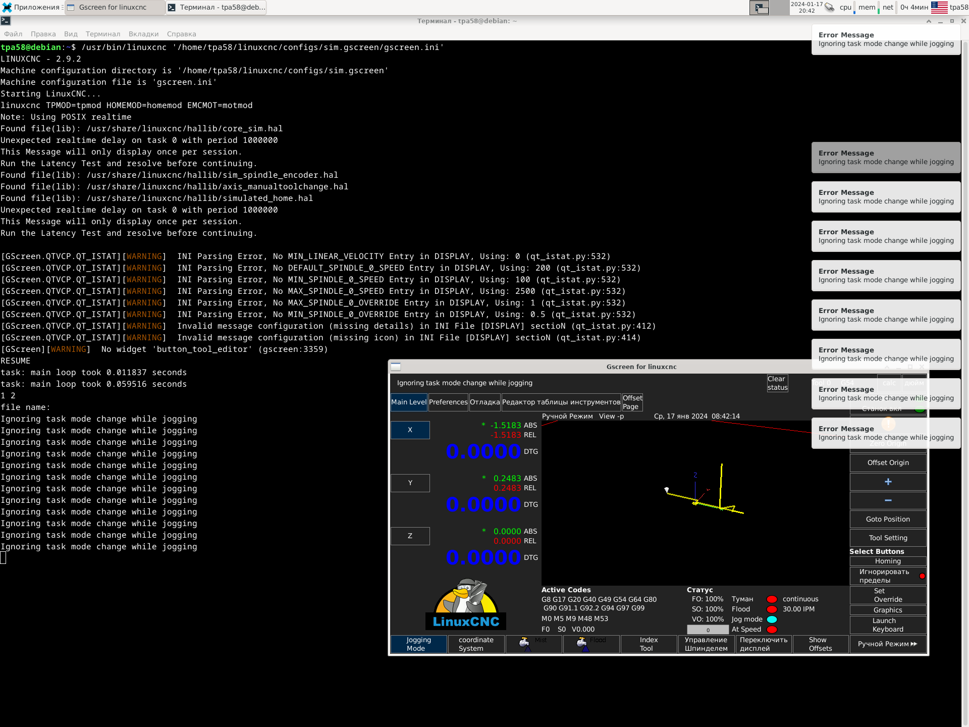

Message: "Ignoring task mode change while jogging"
- tpa58
- Posts: 2
18 Jan 2024 08:52 #291006
by tpa58
Message: "Ignoring task mode change while jogging" was created by tpa58
I runing base example sim.gscreen or sim.gscreen.silverdragon. After ON, homing, select axis and jogging mode I try JOG + or -. Axis moving, but every click i get message "Ignoring task mode change while jogging"... LinuxCNC 2.9.2 on VirtualBox.
I would be grateful for any advice.

This is jogging by mouse-click?
If it is reproducible in the supplied sim configs (and it sounds like that is what you are using) then you should probably raise an error report here:
github.com/LinuxCNC/linuxcnc/issues

I confirm, the same problem. It happens exactly when the key is released and gscreen calls
Thus it calls jog while the other is still in progress. If the movement is incremental and the key is not released until the movement is complete, then there is no error. In the source code it looks like this:
I thought the problem was with my custom panel implementation, but the standard one has the same problem. Any ideas on how to fix this?
self.gscreen.do_key_jog(_X, direction, False)Thus it calls jog while the other is still in progress. If the movement is incremental and the key is not released until the movement is complete, then there is no error. In the source code it looks like this:
int emcTaskSetMode(EMC_TASK_MODE mode)
int retval = 0;
if (jogging_is_active()) {
emcOperatorError("Ignoring task mode change while jogging");
return 0;
...I thought the problem was with my custom panel implementation, but the standard one has the same problem. Any ideas on how to fix this?

It's all about this line:
I commented it out and the errors stopped appearing
Is it necessary if we are already in JOG mode?
self.emc.jogging(1)I commented it out and the errors stopped appearing
def do_key_jog(self,axis,direction,action):
if self.data._JOG in self.check_mode(): # jog mode active:
if not action: cmd = 0
elif direction: cmd = 1
else: cmd = -1
self.emc.jogging(1) <-- HERE
#print(self.data.jog_increments[self.data.current_jogincr_index])
if self.data.jog_increments[self.data.current_jogincr_index] == ("continuous"): # continuous jog
#print("active axis jog:",axis)
self.emc.continuous_jog(axis,cmd)
else:
#print("jog incremental")
if cmd == 0: return # don't want release of button to stop jog
self.mdi_control.mdi.emcstat.poll()
if self.mdi_control.mdi.emcstat.state != 1: return
jogincr = self.data.jog_increments[self.data.current_jogincr_index]
distance = self.parse_increment(jogincr)
self.emc.incremental_jog(axis,cmd,distance)Is it necessary if we are already in JOG mode?
