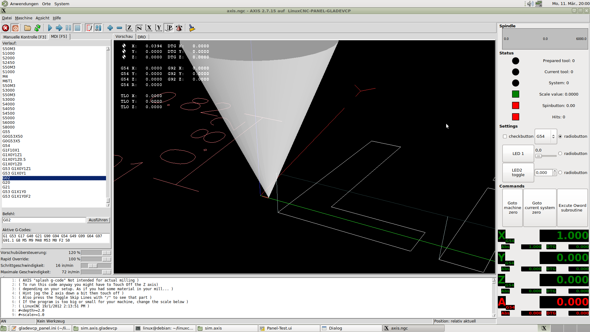

Hello together,
I am trying to implement the combi DRO widget into the Glade Panel example, but the background color is only visible around the text.
Is there a setting to fill the whole DRO area or has it something to with the Hal table used in glade to position the single DRO-modules.
Running version 2.7.15

I figured it out: it was because I was using a HAl-table instead of a "normal" table.
