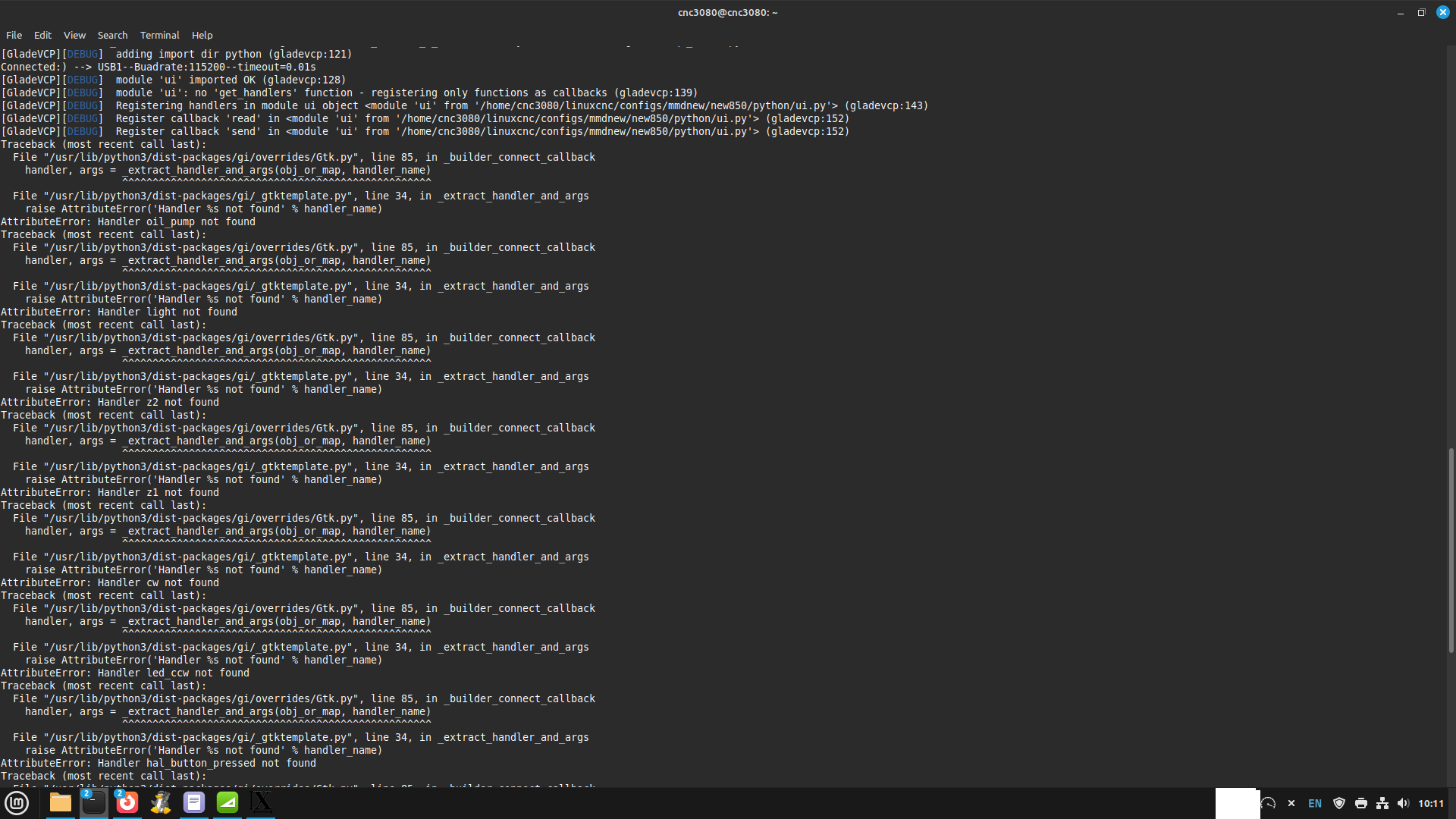

I was using linuxcnc 2.8.4 on linux mint 19.1 and I decide to update to a higher version, so I use this version
forum.linuxcnc.org/9-installing-linuxcnc...int-debian-edition-6
After hours of trying I stuck in this one
It looks like it can't recognize hal python and hal button
this is my code
this is my code

07 Mar 2025 19:53 #323458
Replied by andypugh on topic python hal glade
You may have cut off the most important part of the error chain, the real problem is likely to be near the bottom.

14 Mar 2025 10:16 #323902
by rockcnc
Replied by rockcnc on topic python hal glade
This is the full error

02 Apr 2025 21:04 #325546
Yes, almost at the bottom:
AttributeError: Handler hal_button_pressed not found
So, in your .ui file there is a button that triggers the event "hal_button_pressed" and no handler for that event in the python.
Looking through the .ui file in a text editor:
in the Python I see:
So you have written the handler, but in my editor the entire code body in the Python file appears to be triple-quoted (lines 15 and 120) and is highlighted in red. It may be that this is causing the whole handler file to be ignored.
cnc11.ui:34: <signal name="pressed" handler="hal_button_pressed" swapped="no"/>
cnc11.ui:49: <signal name="pressed" handler="hal_button_pressed" swapped="no"/>
cnc11.ui:93: <signal name="pressed" handler="hal_button_pressed" swapped="no"/>
cnc11.ui:108: <signal name="pressed" handler="hal_button_pressed" swapped="no"/>
cnc11.ui:123: <signal name="pressed" handler="hal_button_pressed" swapped="no"/>
Found 5 matches for "hal_button_pressed".in the Python I see:
def hal_button_pressed(self, widget, data=None):
print ("on_button_press calllllllled")
s.poll()So you have written the handler, but in my editor the entire code body in the Python file appears to be triple-quoted (lines 15 and 120) and is highlighted in red. It may be that this is causing the whole handler file to be ignored.
