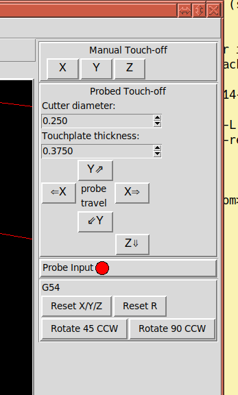

I have a small pyvcp panel that I've used for a number of years. I can't remember what I started with -- probably someone else's work. It does most of what I need, but lately I've thought of a couple of things that would be handy that I should add. But they involve calling external programs, and I'd rather not have to do the M101 dance just to run a shell script.
Anyone have, or have a pointer to, a gladevcp panel that does most of what I've got already? I'd like to start with something close and modify, rather than start from scratch. Screenshot of my current panel attached.

In fact, I did look at Easyprobe yesterday, thinking of upgrading to it -- but decided that with the primitive probing hardware I have on hand, there wasn't much point.

My setup isn't actually *that* primitive. The touch-off plate is a very nice bar of aluminum that is about 2" long and *exactly* 3/8" on every side. I found it in my scrap box, and it already had a threaded hole in one side. Very convenient. And because it's square, I can use it in almost any orientation. (I remeasure it once in a while because I still can't believe that it's exactly square in cross-section.)
In addition to the panel, I have a (shell) script which will tail the probe log, and based on the last two probe entries it will give me either the angle at which the work is sitting (if the probes were both from the same side) or the center point between the probes (if they were in opposite directions). As output it prints the G10 L20 line necessary to make use of the result. So I can do much of what Easyprobe does. Just not quite as Easy.
