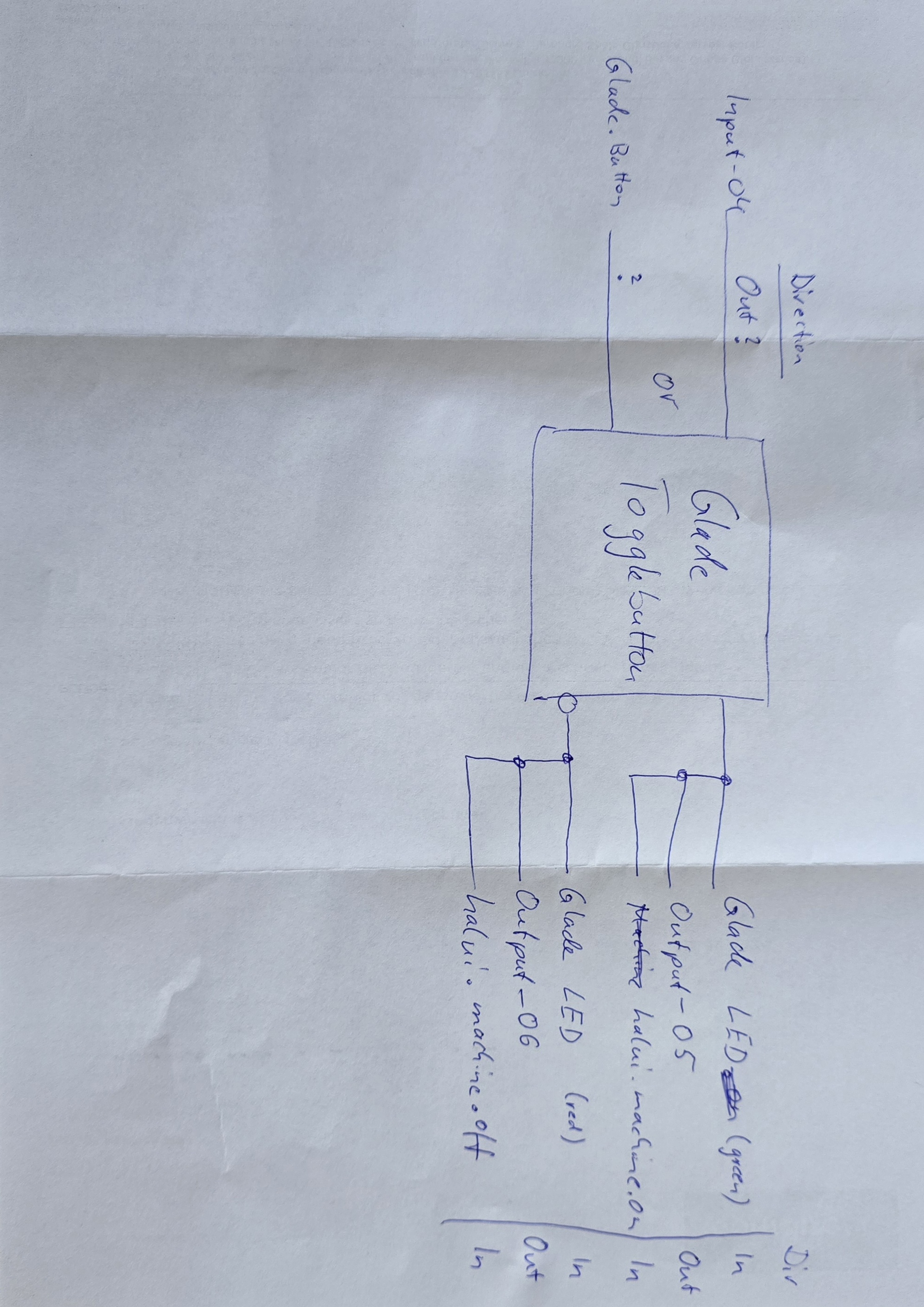

Hello,
i just try to complete the function in the attached file. My postgui.hal:
#[Startknopf]
loadrt or2
addf or2.0 servo-thread
net Start.ext.an <= gladevcp.Start => or2.0.in0
net Start.ext.an1 <= hm2_7i76e.0.7i76.0.0.input-04 => or2.0.in1
net Start.or <= or2.0.out => hm2_7i76e.0.7i76.0.0.output-05 => gladevcp.led_Startstopp => halui.machine.on
#net Start.or => gladevcp.Start-not => hm2_7i76e.0.7i76.0.0.output-06 => halui.machine.off
#net Start.ext.aus => gladevcp.Start-not => hm2_7i76e.0.7i76.0.0.output-06 => #halui.machine.off
I can´t get output-6 and halui.machine.off to work.
Please help

Replied by Aciera on topic Combine Glade Togglebutton with Physical Input
you might have to use the 'not' component:
loadrt not
addf not.0 servo-thread
net your_signal not.0.in
net your_signal_inverted not.0.out

by DerKlotz
Replied by DerKlotz on topic Combine Glade Togglebutton with Physical Input
Tried something, but to much chinese
. I did some comments after #
#[Startknopf]
loadrt or2
loadrt not
net Start.not.in => not.0.in #<= ???? must be hm2_7i76e.0.7i76.0.0.input-04
#net Start.not.out => not.0.out
#net Start.or <= not.0.in => hm2_7i76e.0.7i76.0.0.output-06 => halui.machine.off
remove the led pin from where you have it and connect it to the the halui.machine.is-on pin instead:
Code:
net some_signal_name <= halui.machine.is-on => gladevcp.led_Startstopp

by DerKlotz
halui.machine.is-on is already linked to machine-is-on
I´ll continue tomorrow

by DerKlotz
So i disabled
#net machine-is-on halui.machine.is-on
in my machine.hal
and did this in my custom_postgui.hal
net MachineLED <= halui.machine.is-on => gladevcp.led_Startstopp
Hello,
this is my almost working postgui. This works is Input-04 is a switch. But i want to use a push button. What can i do?
#[Startknopf]
loadrt or2
loadrt not #mit diesem Befehl wird ein not.in/out in die Pins geladen
net Start.not.out => not.0.out # hier wird not.0.out startbar gemacht
net Start.or <= or2.0.out => hm2_7i76e.0.7i76.0.0.output-05 => halui.machine.on => not.0.in # Eingang not.0.in wird über den or2.0.out gesetzt
net Start.not.out => not.0.out => hm2_7i76e.0.7i76.0.0.output-06 => halui.machine.off
