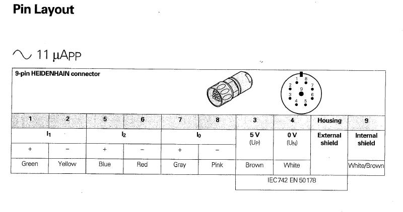

I've dug around and found snippits of info that point to it being a 11uApp device. Here's a thread for an ERO similar to mine.
I can't find official docs from Heidenhain out there either. A couple of leads point to cncrotary.com or call Heidenhain directly.
Plan A is to re-use the original control board, Plan B is the EXE devices.
Jay
19 May 2012 21:29 - 19 May 2012 21:53 #20230 by cmorley
Replied by cmorley on topic Re:Bridgeport Series II Interact 2 Conversion
it seems that the ERO 115 is an 11 micro amp signal encoder, according to another linuxcnc user:
www.linuxcnc.org/index.php/english/compo...iew&catid=27&id=1589
he actual has the specs if you can get a hold of him..maybe his email is still valid.
There is also another fellow on that thread that just used the original converter board - there is a pic....
Last edit: 19 May 2012 21:53 by cmorley.
  • KPA
  • KPA's Avatar Topic Author
  • Visitor
  • Visitor
20 May 2012 00:28 #20231 by KPA
Hah! not 1 hour before I read this I found that thread and sent an email - hopefully he's still in touch.
03 Jun 2012 00:20 - 03 Jun 2012 00:21 #20620 by maxvdh
I have the same machine but it originally had a Heidenhain TNC151 controller. Attached is some info on the encoders. I corresponded with Heidenhain about them a bit. I would recommend getting 602 boxes for them. I used 602D/5 boxes. They were $50 apiece on ebay and it kept my original controller intact. If you do want to go the route of using the original encoder board, I have some info on that too but it's somewhat involved and there are no guarantees. I don't know what your electrical skills are like but if you're uncomfortable with that, the 602 boxes are an easy solution.

04 Jun 2012 14:32 #20644 by KPA
Maxvdh,
Good information. Do the 602D boxes work with the Handwheel as well - or is that a digital signal already?
I just borrowed a scope from a friend and as soon as I get out from under tax season I'm back on this. My electrical skills are definitely rusty as I haven't done any deep dives like this for some twenty years. It's tempting to use the 602 boxes and sell the TNC145 on eBay.
Jay
04 Jun 2012 19:46 #20655 by maxvdh
The 602D boxes do seem to work for the handwheel. I ended up buying a no-interpolation factor version of the 602D for the handwheel - it gives more than enough resolution. They're cheaper too. If you want to give me an email address, I can fwd you the info I have on using the 151 encoder interpolation board but of course I can't guarantee that it is identical to the 145.
