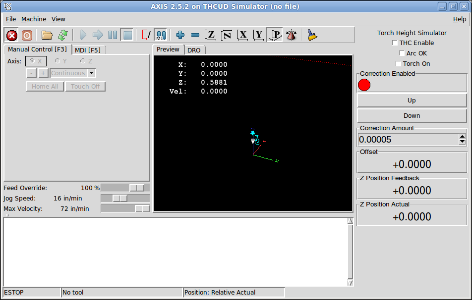

I created a THC (Torch Height Control) Up Down simulator based on the Axis simulator.
This simulation is to demonstrate how the thcud component works with an Up Down Plasma THC device.
In order to use this simulation you will have to install the thcud.comp that is attached to this message.
JT
if you don't have dev installed open a terminal and say
sudo apt-get install linuxcnc-dev
to install open a terminal and cd to where the file is and use the following command
sudo comp --install thcud.comp

Thank you for this tutorial, but when I type the command I have an error?
manu@debian:~/linuxcnc/thcud$ sudo comp --install thcud.comp
sudo: comp: command not found

hello I have to type that operate
sudo halcompile --install thcud.comp
but I did not toujour thc part, I have rebooted the computer but nothing
t is it something else to do?
I have to copy the file in .comp home / manu / linuxcnc / thcud
I have linuxcnc 2.7.4 debian

Can you paste the complete output of the sudo halcompile --install thcud.comp command?

manu@debian:~$ cd linuxcnc
manu@debian:~/linuxcnc$ cd thcud
manu@debian:~/linuxcnc/thcud$ sudo halcompile --install thcud.comp
[sudo] password for manu:
make KBUILD_EXTRA_SYMBOLS=/usr/realtime-3.4-9-rtai-686-pae/modules/linuxcnc/Module.symvers -C /usr/src/linux-headers-3.4-9-rtai-686-pae SUBDIRS=`pwd` CC=gcc V=0 modules
make[1]: entrant dans le répertoire « /usr/src/linux-headers-3.4-9-rtai-686-pae »
CC [M] /tmp/tmpiIUt81/thcud.o
Building modules, stage 2.
MODPOST 1 modules
CC /tmp/tmpiIUt81/thcud.mod.o
LD [M] /tmp/tmpiIUt81/thcud.ko
make[1]: quittant le répertoire « /usr/src/linux-headers-3.4-9-rtai-686-pae »
cp thcud.ko /usr/realtime-3.4-9-rtai-686-pae/modules/linuxcnc/

Are you trying to add thcud to a very old version of LinuxCNC or EMC or did you modify it? It's been in LinuxCNC since 2.6 or so... if you modified it pick a new name.
