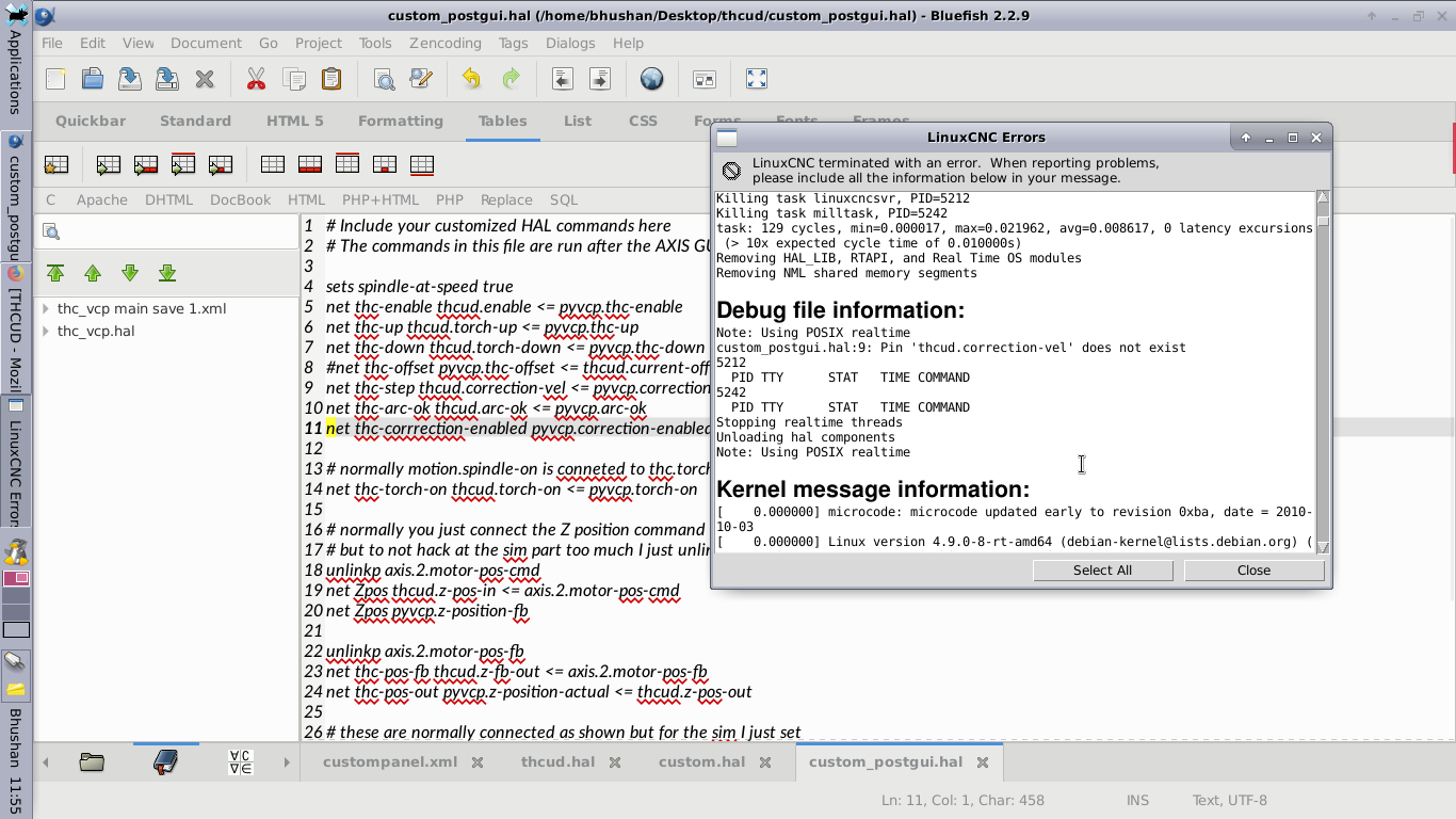

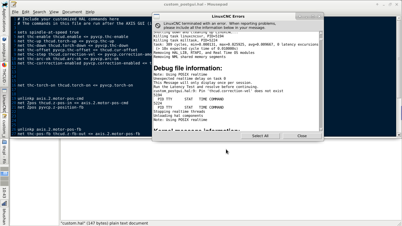

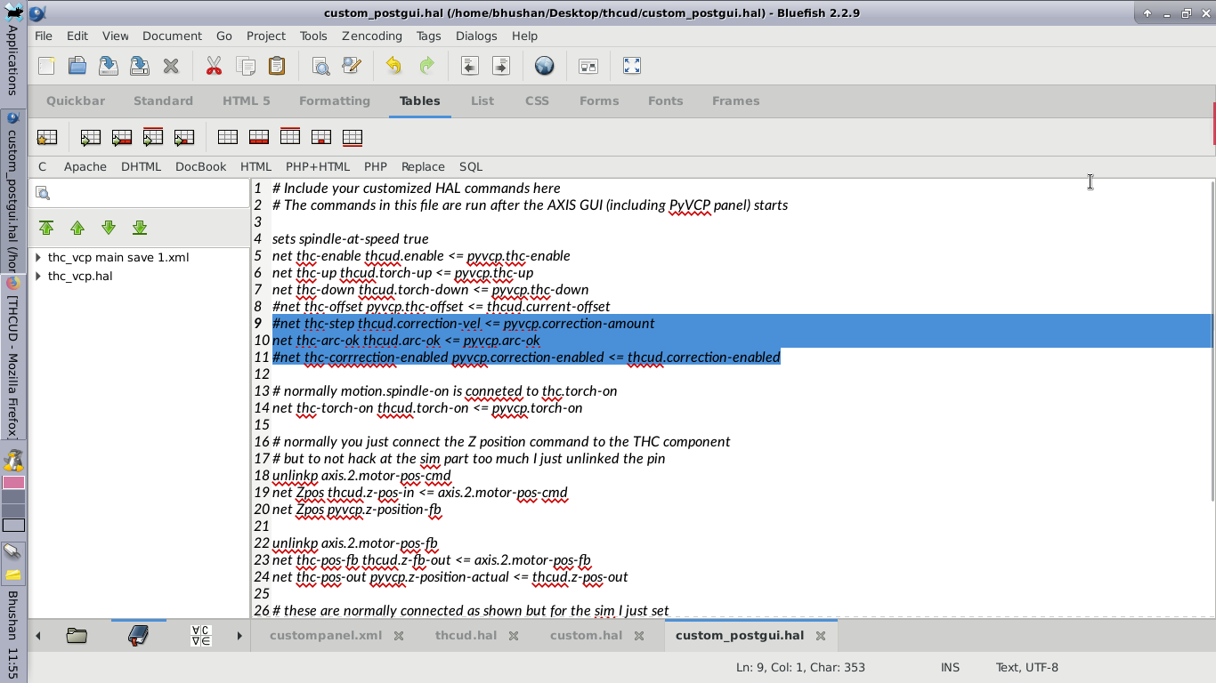

when i run your config it shows following error after i comment out correction velocity and offset as you can see it works
how to solve it ??
how to solve it ??

as you comment it out
please check the THCUD pinnames
in Halshow
Halmeter
the pins have chand from 2.6 to 2.7
loadrt thcud
addf thcud servo-thread
net spindle-on <= motion.spindle-on => thcud.arc-ok thcud.torch-on
net CurVel thcud.current-vel <= motion.current-vel
setp thcud.requested-vel 15.0
setp thcud.vel-tol 8.0
setp thcud.correction-vel 0.001
There may be other pins or names
THIS config is as of 2.6 2013
