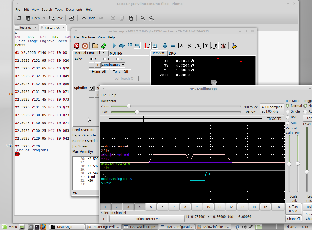

Could you try riposting the G-code file. It didn't come through.
For Halscope, you have to set a signal source as the trigger, then set the trigger level to something appropriate.
linuxcnc.org/docs/html/hal/tutorial.html#_triggering
At 420mm/min (7mm/sec) you should be good down to about 0.007mm resolution. I think the key to what might be wrong may lie in your g-code.

For the g-code, I started with my base file I'd been testing with before and slowly adjusted it from there (mostly removing every other line of code to double the distance until I started to need more lines of code so that it would adjust the M67 values a bit more (because to many lines of code had been deleted).
Posted here, thanks for taking a look.

On a slightly unrelated note, when I was testing I noticed that the behavior of M67 was not as I expected from the description in the doccumentation. When I had an M67 command on the same line as a commanded move, I would have expected the M67 command to be executed at the end of that move or the start of the next (or maybe the value of the output is interpolated through the duration of the move), but what actually happens is that M67 is activated at the beginning of the move in the line commanded. So if the machine is a X0 and G1X1M67E1Q0 is commanded, the output is set to 1 and the machine BEGINS the move to X1.
sois the same asand that is not the same as this, which gives the result I would have expected from the 2nd bit of code.
so
G0X0
M67E1Q0
G1X1
G1X2G0X0
G1X1M67E1Q0
G1X2G0X0
G1X1
M67E1Q0
G1X2Please Log in or Create an account to join the conversation.

Rob, your 0.3mm test g-code runs fine in my simulation at up to about F3000. Looking like the fault may lie in your machine configuration.
A quick glance at your ini file shows that your max velocity is set to 7mm/s and the acceleration is only 5mm/s~2. Both seem rather lethargic to my eye. (I am used to seeing numbers 10-30 times those or more) Are you sure that your machine has to move that slowly?
But I kind of doubt that is the real source of the problem.

Will it tell you what the velocity is dropping to when it executes that 2nd y-move code (with Q20)? I see a sharp point there where it looks like velocity drops considerably and then shoots back up. Based on the rest of the graph that looks like the v=0 point. If that is actually what's happening in your simulator then that would be somewhat similar to how mine keeps dropping off somewhat near the same point.
If I was good with halscope we could probably figure out if they were dropping off at precisely the same time. The remainder of the difference in your velocity graph and mine could then be summed up in acceleration rates most likely. My graph takes the long slow journey towards velocity = 0 because my acceleration values are so low. In your simulated mode your accel values are probably >>> greater than mine, hence the reason yours can drop to zero and recover within such a short time.
It could be my eyes playing tricks on me, but your graph appears to follow the same acceleration rate (linear velocity increase) during "movement start" and the quick (what I am calling) v=0 point of your graph, although the deceleration rate at the v=0 point is not the same as your ending deceleration rate; potentially interesting but for another discussion.
