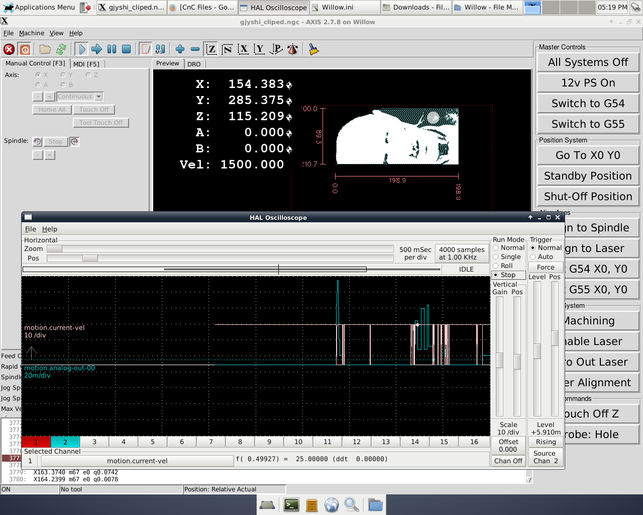

Wow, your file is brutal. Haven't seen my average velocity that low in a long time. Like yikes, I might have got up to 50mm/min once or twice near the shirt/shoulders on the top right,and then not up to speed (420mm/min) until the long straight away.
The photo doesn't do justice to how bad the velocities were. It looks like it went all the way down to v=0 at one point -> ouch!
Gonna test a few more things, kick my velo and accel up and see if I can replicate the graph that Todd got before, to see if its related to velo and acceleration.

Oh well, you do have acceleration problems, as Tod mentioned, you should have changed that but you can leave velocity as is.
I have acceleration set at 5000 or 2000 depending on the machine, and that file runs fine up to 3000mm/minute.
I did test that file, they are my grandfather and grandmother on fathers side, came out really nice.

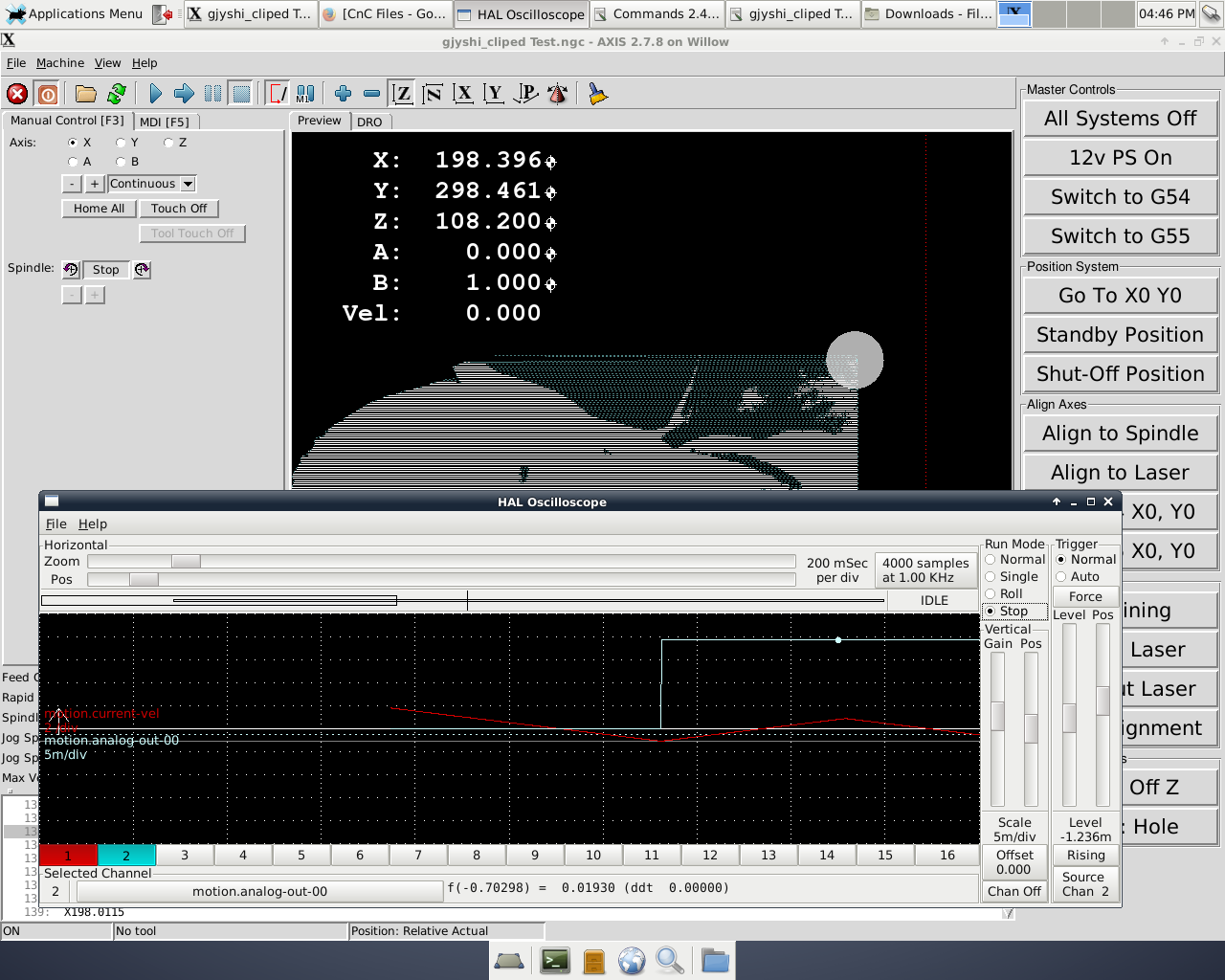

In the Halscope plot I posted, the first move of the file is moving from where the file ended (from previous run). That is the first long velocity move, then the axis reverses direction, resulting in the deceleration to 0 (the point in the middle). Finally the move(s) with the M67 codes, were all made without any change in velocity.
I don't know what is up with the deceleration your seeing. (I haven't taken the time to look at the code Tommy posted.)
What sort of arrangement do your have for your X-axis bearings your having trouble with. Maybe we could suggest a simple improvement. I maintain a machine at work with a seriously overloaded axis and it eats bearings as well.

Will it tell you what the velocity is dropping to when it executes that 2nd y-move code (with Q20)? I see a sharp point there where it looks like velocity drops considerably and then shoots back up. Based on the rest of the graph that looks like the v=0 point. If that is actually what's happening in your simulator then that would be somewhat similar to how mine keeps dropping off somewhat near the same point.
If I was good with halscope we could probably figure out if they were dropping off at precisely the same time. The remainder of the difference in your velocity graph and mine could then be summed up in acceleration rates most likely. My graph takes the long slow journey towards velocity = 0 because my acceleration values are so low. In your simulated mode your accel values are probably >>> greater than mine, hence the reason yours can drop to zero and recover within such a short time.
It could be my eyes playing tricks on me, but your graph appears to follow the same acceleration rate (linear velocity increase) during "movement start" and the quick (what I am calling) v=0 point of your graph, although the deceleration rate at the v=0 point is not the same as your ending deceleration rate; potentially interesting but for another discussion.

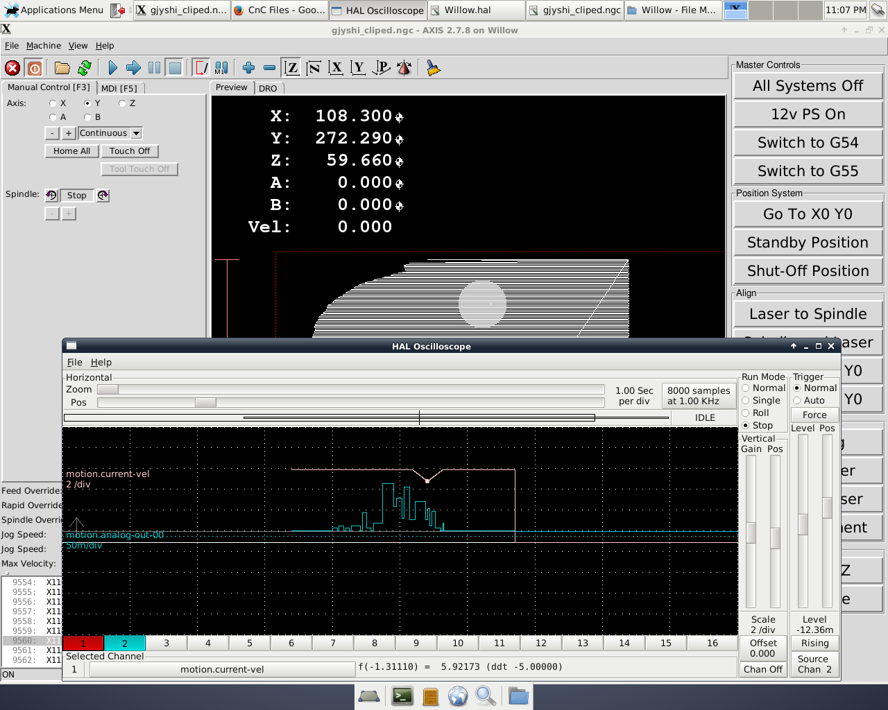

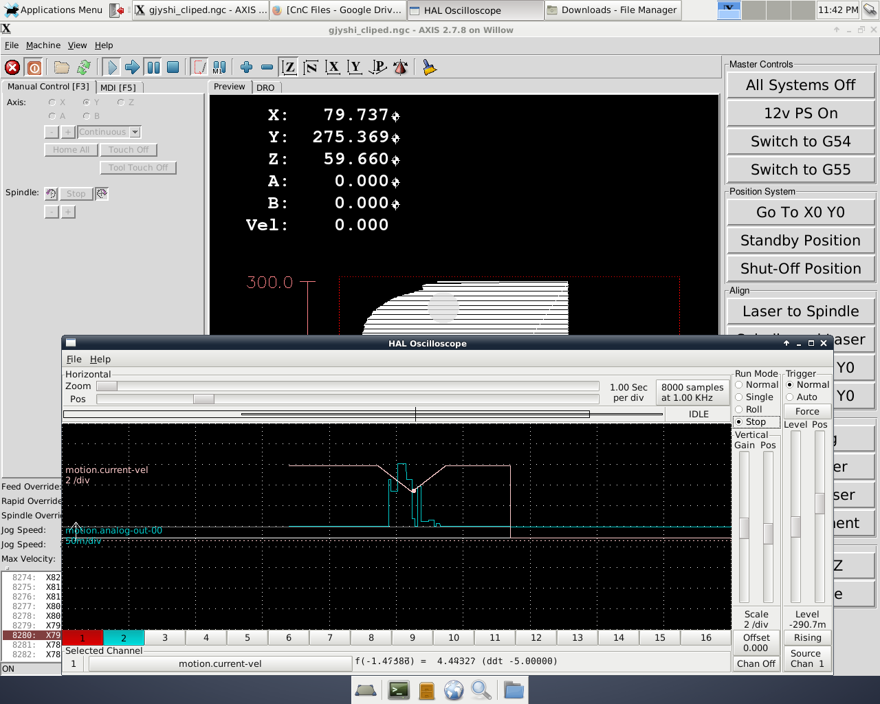

Thanks for pointing that out, I was overlooking the obvious (duh!) that your axis had to first position itself, come to a stop, then execute the file. Makes perfect sense now once looking at the graph and file.
So I revisited my good M67 buddy and have the following thoughts:
1.) Acceleration is not a factor
2.) Velocity is not a factor
Based on those two, for now I am ruling out modifications to the .ini file, as the servo thread and axis values 'should be' fine
So I looked at the .hal files, and what I could do to improve. So far all I have found to help is moving the analog motion code block:
loadrt pwmgen output_type=0
addf pwmgen.update servo-thread
addf pwmgen.make-pulses base-thread
setp pwmgen.0.enable TRUE
net laser-pwm-generator motion.analog-out-00 => pwmgen.0.value
net linux-to-laser-driver-board-signal-00 pwmgen.0.pwm => parport.0.pin-03-out
from custom.hal to willow.hal (mymachinename.hal -> the first hal loaded (as best I'm aware anyway), before custom.hal and before custom_postgui.hal). This improves performance and I am at the following graph now:
This is better than I was getting before, with velocity dropping to 5.9mm/sec (vs 7mm/s max, or ~15% drop). The drops are far less frequent then they were before, and velocity is not dropping anywhere near 0 as it previously was. Can't explain that yet, maybe the order of loading hal components matters? Not sure on why the sudden improvement....still pondering that. Also, I can't explain that temporary drop in velocity, but its a lot better than it use to be for what that's worth.
In looking at the hal and ini files I noticed that I'm still loading the A-Axis from when I was testing with it, so I will remove it to ensure its not unnecessarily hogging resources as well.
This is better progress then I've made recently, so thanks to all for the help so far.
I had a test file running while making this post, and notice a bit bigger drop.
This one was down to ~4.5mm/s, or 35% drop (close to the 40% velocity loss I was experiencing before). So for sure some problem remains, but its not dropping to 40% velo near as often as it was before, for what that's worth.
I will work on this more this weekend and report back.

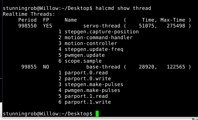

The order that components are loaded is not important, but the order that they are added to the servo thread matters.
You should read inputs, then do calculations, then write outputs.
You can actually add a number to the end of an "addf" command to force a position in the thread sequence. positive numbers from the top, negative numbers from the bottom.
With Linuxcnc running you can run the command "halcmd show thread" in a terminal to get a list of the functions and the order they are executing. Make sure that they are in the read-process-write ordering.
Replied by andypugh on topic Allow infinite acceleration/speed on one axis

Thanks for the heads up about the loading order. I've never adjusted it before. Here's what I have now:
For the servo thread I'm not sure if anything there needs to be reordered?
For the base thread, should I reorder it to load as follows:
parport.0.read
parport.1.read
stepgen.make-pulses
pwmgen.make-pulses
parport.1.write
parport.2.write
Its not much of an adjustment, but perhaps it matters as you've pointed out.
Note: I see that my servo thread 'max time' is less than my servo thread period, while the same is not true for the base thread (122k vs 100k). Perhaps this is potentially where the random flutter I am getting on M67 commands is coming from? I've never adjusted or worried much about these values as the machine has worked well for cnc and vector engraving, but maybe now that I'm doing raster the max-time in the base thread is causing me some problems?
parport.0.read
parport.1.read
stepgen.make-pulses
pwmgen.make-pulses
parport.1.write
parport.2.write

You might be able to move parport.read to the servo thread if you are not reading encoders.
