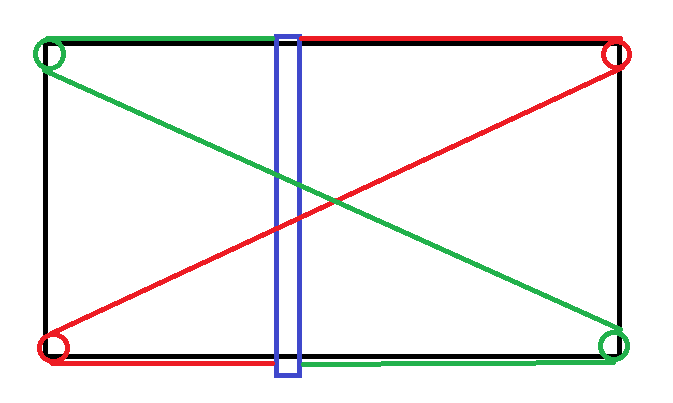

I've been running a gantry style plasma setup with one motor on each axis. Recently I added an second motor to the other end of the X-axis. The second motor on the X-axis smaller than the first one. The first X-axis motor is belt driven and the new second one has an inlineskate wheel attached to it which is running against the steel frame (spring loaded).
I've been looking at the threads which contain information about using two motors on the same axis (e.g. gantrykins) but so far I have not found a thread which would cover this topic: using to different size motors / pulleys on the same axis.
So to sum up: what would be a good way of running a system which has two different size motors / pulleys on the same axis?

I believe this will require a custom kinematics. You will need to use two joints, one for each drive of the x-axis, the differential gearing will need to be figured in the kinematics file to make it work correctly.
I would try to get it to work so that both drives are the same gear ratio anyway. Should not make much difference if the motor is smaller as long as it has the same steps per inch. Then you can use gantrykins or trivkins.

Are you saying that the extra axis is friction-drive?
That won't work, it is bound to creep and end up out of synch with the geared drive.

Yes, the second drive is a friction one. A big NO NO, I know.
I know this is not the best setup to go with. My first intention was to use only three stepper motors (single sided motor on the X-axis). When I realized that the the X-axis was not stable enough I ended up installing the second stepper to the other end of the X-axis as an "assistant motor" to stabilize the axis. And now I'm here. I've learned my lesson, the next design will have two motors or an axle to the other side (either way similar gear ratios and driven from both sides). I think my choices basically are: renew the frame/axis design, stiffen up the X-axis and stick with the original single sided plan OR get the second stepper configured on the X-axis.
I guess there are a few complex choices to configure the second stepper on the X-axis, I have to dive a bit deeper into the configuration of LCNC to understand how to get things working.
I should have photos, sorry about this. Unfortunately the plasma is not where I'm at the moment. Here is a screencap of the CAD model of the overall setup (table size 1x2 meters):
