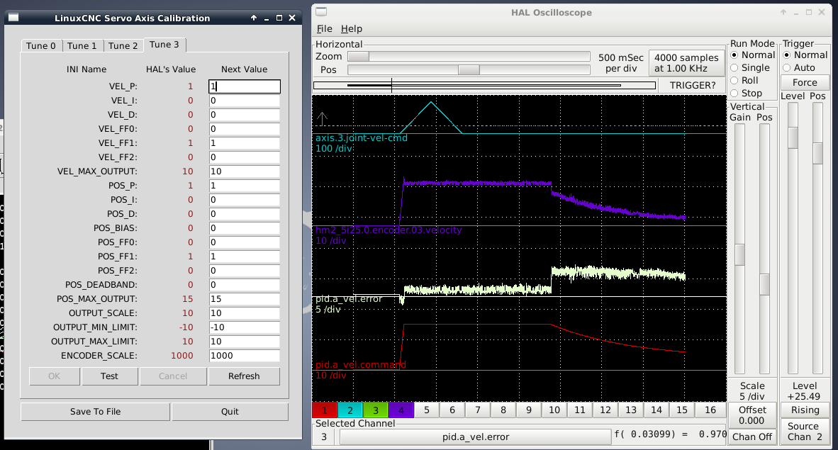

Ok, here's my new baseline. Nasty, but I have to say that the motion does already seem more consistent. I'm getting HF oscillations and very slow motion compared to the last tuning attempt.
I'm running the following to trigger the scope:
Also a snippet of my INI and HAL for the axis I'm working on (complete "work in progress" files attached):
G91 G0 A40Also a snippet of my INI and HAL for the axis I'm working on (complete "work in progress" files attached):

Looking at your tuning screen shots, it appears that all three of the VEL parameters in the screen shot should overlay almost perfectly. Not quite there yet.
