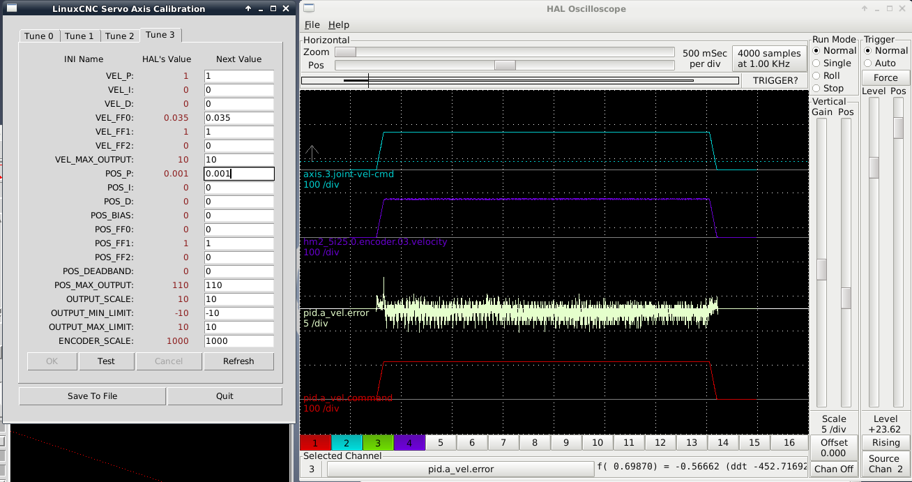

I'm going to call this progress. All three of the monitored velocity parameters now mostly mirror each other. The one thing I had to change, which I don't understand, is the POS_MAX_OUTPUT. This was set to 15 in your file, so I copied that. Then I noticed that my velocity was being capped at 15, so I tried changing it to the same as my current MAX_VELOCITY, 110. That did the trick, but why does the POS parameter control the VEL? I also reduced the POS_P by a lot and this seems to have helped.
- Sparky961
- Posts: 210
- Thank you received: 15
29 Mar 2016 01:43 - 29 Mar 2016 02:22 #72284
by Sparky961
Replied by Sparky961 on topic Rotary table configuration
Ah, much nicer now. It moves at the max velocity, from my calculations based on motor RPM and gear reduction, and the velocity curves all match. Considering this is a rotary axis where units are in degrees and velocity in degrees/min (I think), how concerned should I be about the error seen in the screen shot? P-P is about 5 units, or an instantaneous variation of up to 5 degrees/min while cruising. Again, if I'm reading everything correctly here. I was able to center it around 0 using FF0 but couldn't figure out how to reduce the amplitude.
** EDIT: Above should ready degrees/SECOND not minute. Velocity is in machine units per second... which has bitten me more than once now.

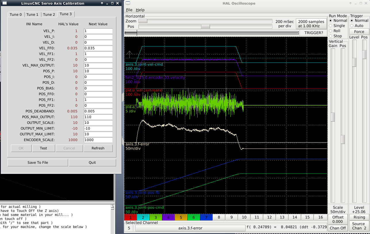

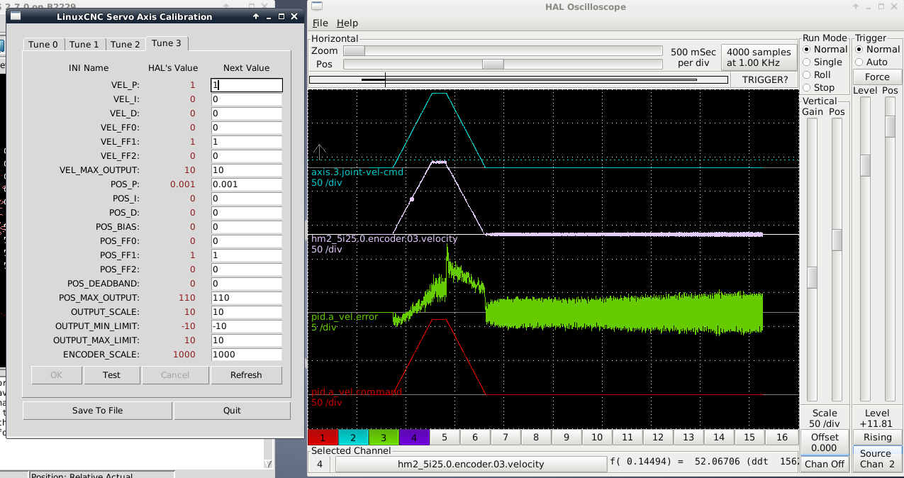

29 Mar 2016 03:47 - 29 Mar 2016 03:52 #72289
by Sparky961
Here's where things stand as of bed time tonight.
I've made an attempt at proceeding to tune the position loop, but this seems a bit more difficult. Maybe I didn't get the velocity loop right? Sure looked good. I'm having two issues with the position loop: a) The actual position isn't reached, unless I turn up POS_P fairly high, and b) when POS_P is high it seems to cause the high frequency noise that's seen in the screen shot. Or perhaps this is coming from somewhere else. Not sure, but leaving it for tonight.

Oh, alright... one more before my eyes close on their own. I took your suggestion of removing the FFx from the velocity loop and tried (without much luck) to reduce the noise in the error with D. It seems like it's working better now when I start increasing P in the position loop. But really I'm mostly just using trial and error at this point. Need sleep.

29 Mar 2016 13:23 #72322
Replied by Todd Zuercher on topic Rotary table configuration
Have you tried to reduce the vel_P a little? Try 0.5
You can take the position loop completely out of the equation (just for tuning the velocity loop) by temporarily connecting the axis.3.join-vel-cmd directly to the velocity pid command input.
(guessing at your pin and signal names for your hal file somthing like this)
at a hal command prompt type
unlinkp pid.a_pos_output
net a-vel-output axis.3.joint-vel-cmd
It also can be helpful to look at the output of the velocity loop pid in hal scope to see if it is maxing out.

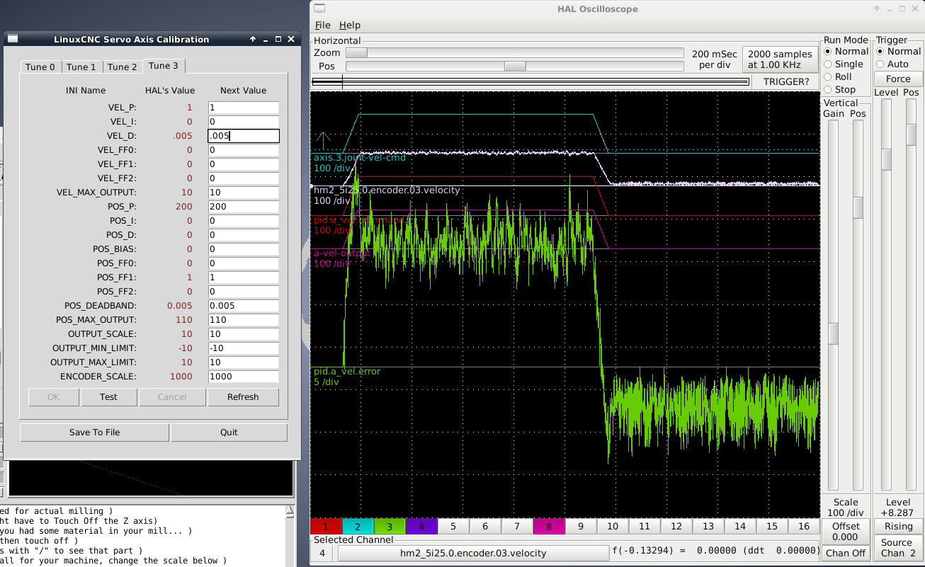

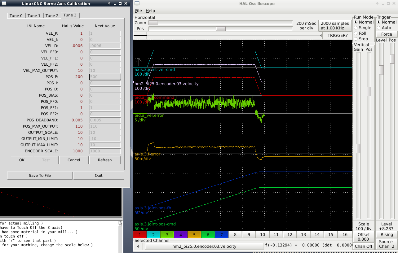

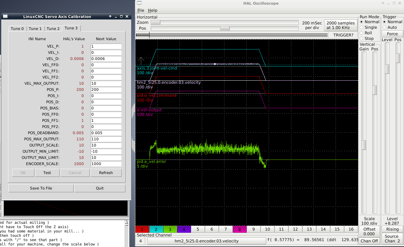

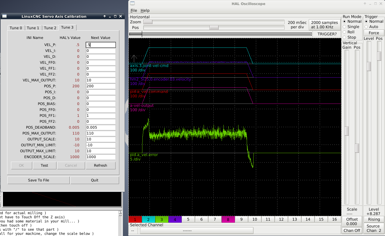

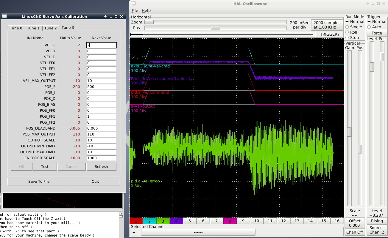

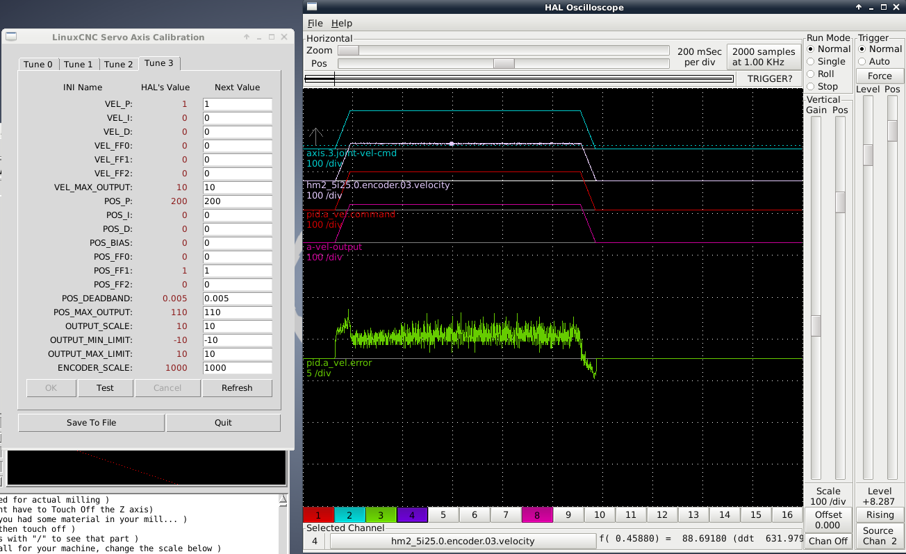

30 Mar 2016 00:36 - 30 Mar 2016 00:49 #72354
by Sparky961
Definitely interesting reading, but I'm not sure I'm quite there yet. Still crawling here, not yet walking.
I added the suggested debug lines to the end of my HAL file because I couldn't for the life of me figure out how to start a HAL command prompt while LinuxCNC was already running. I didn't get any errors and the positioning lost any semblance of accuracy, so I'm assuming it took.
Unfortunately I'm finding that the VEL_D I added earlier doesn't do much of anything. See next two screen shots...
Increasing VEL_D much more than I had it set causes bad things to happen...
So, let's forget about VEL_D for now and try adjusting VEL_P up and down...
Halving VEL_P results in roughly doubling pid.a_vel.error, and no improvement in the noise superimposed on the signal:
Doubling VEL_P results in .... ahem .... ya. Clearly not the direction I need to be going.

30 Mar 2016 02:40 #72358
If what you had before was looking good enough for you then run with it.
As far as how fast to test at I don't know, I would think that somewhere in the range of speed you'd expect to use most. Most of the tuning instructions for drive tuning I've looked at only use a relatively small move at a moderately slow speed, but with a square wave input, and you are trying to get the move to match as closely as possible to the command.
One more thing that might be informative to look at is what does the output to the amp look like?
pid.a_vel.output
Just to make sure your not saturating your torque command or bouncing off the hi low (+/-10v) limits.
pid.a_vel.output
