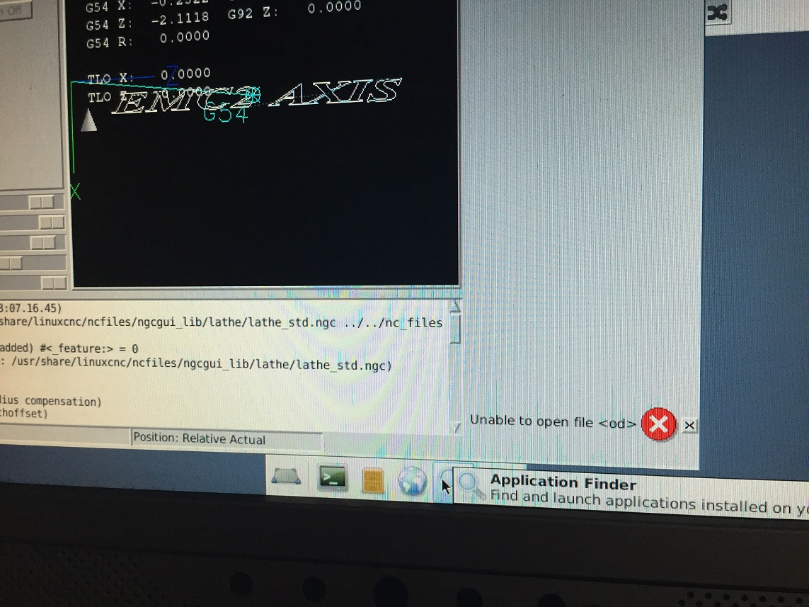

Tried it, those are some nice features. But when I try to load the file in my setup, I get the error message, for instance I tried the OD template, and I get the "unknown o..."

Can you post the exact error message you received and what you did to get it?
You can switch between inch and millimeters with G20 / G21
The start up and or preamble may set set your machine to inch or millimeters. When using ngcgui if you look in the .ini file you should see something like...
NGCGUI_PREAMBLE = lathe_std.ngc
and lathe_std.ngc will be run when you create and run a ngcgui feature.
In the sample files lathe_std.ngc looks like...
You could edit that to use G21 instead of G20 then save it as say lathe_mm.ngc the edit your .ini file to...
Rick G

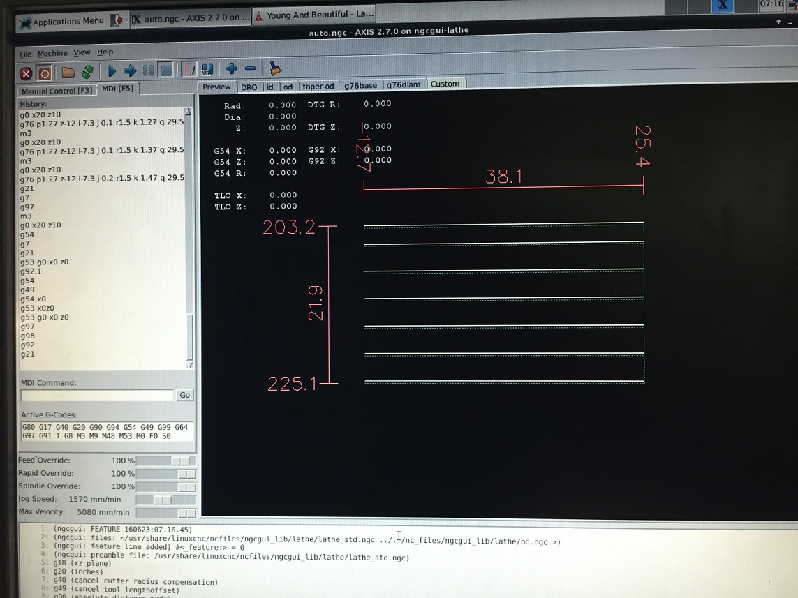

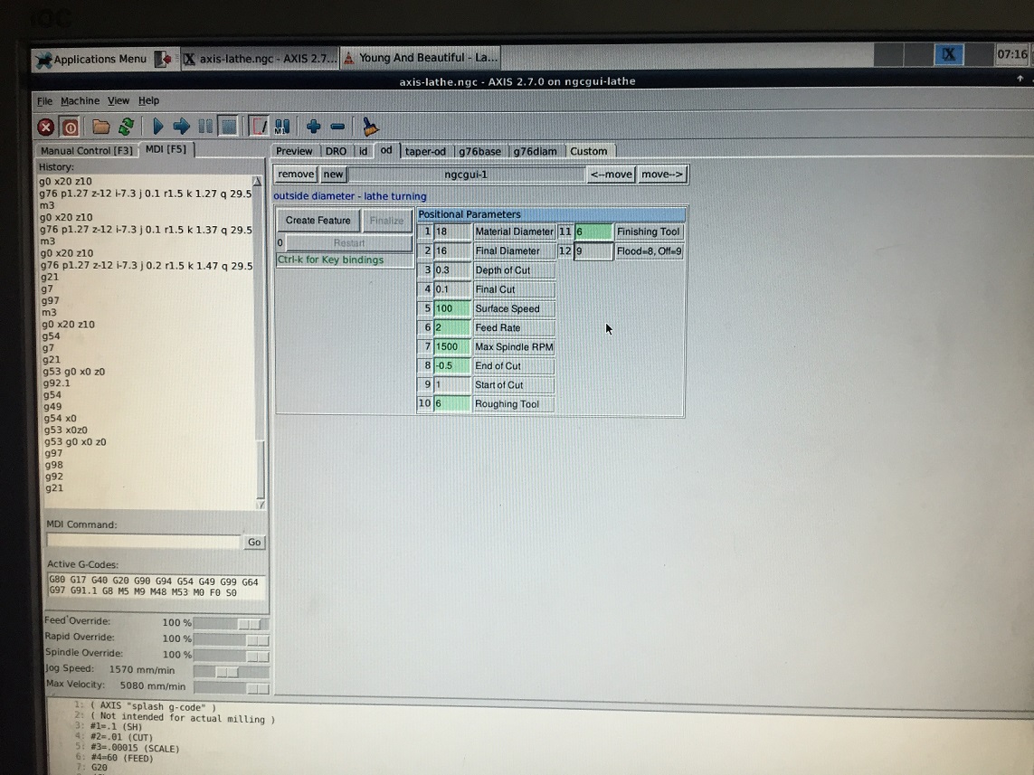

I ll try to insert the images of whats going on when I try the OD.
- Posts: 19899
23 Jun 2016 16:21 #76501
Replied by andypugh on topic Getting started with Linux, LinuxCNC and CNC
Where are you saving the file to?
- Todd Zuercher
- Posts: 4793
- Thank you received: 1480
23 Jun 2016 16:22 - 23 Jun 2016 16:25 #76502
Replied by Todd Zuercher on topic Getting started with Linux, LinuxCNC and CNC
Sounds like it can't find the sub program named "od.ngc".
Should be as simple as saving the file in the right place, or correcting the path name in your ini file.

Umm, in a folder on desktop where I save all my ngc files. I m still new at using this
I havent tried to save it in a place where it prompts me to do it
Last edit: 23 Jun 2016 16:24 by sharpshooterser.
- Posts: 19899
23 Jun 2016 16:38 #76505
That's fine, but you need to tell LinuxCNC to look there:
linuxcnc.org/docs/2.7/html/config/ini-co...ml#_rs274ngc_section
You might as well add that folder to M-path and Subroutine path.
By default linuxCNC only knows to look in ~/linuxcnc/nc-files

Take a look in your .ini file there should be a line similar to...Copy the .ngc files you want to use such as od.ngc to that directory so linuxcnc can find them.
Or as Andy said you can also add the proper information to the .ini file for the directory that you want yo use instead.
