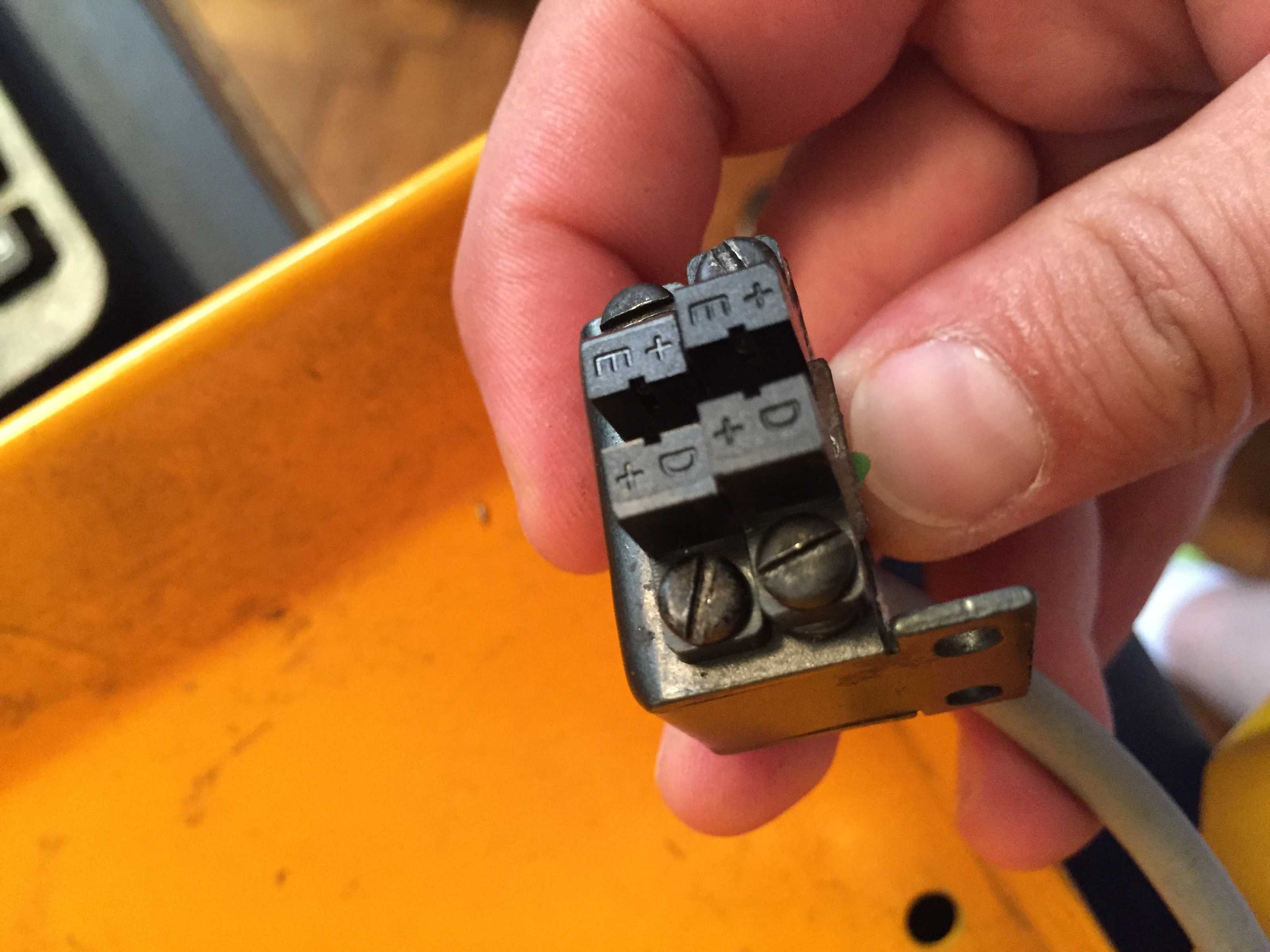

Just another thought, on the interrupter itself (a+z) there are no resistors. They must be inside somewhere on the board so maybe just hooking the wires up directly to the board itself isnt a way to go?

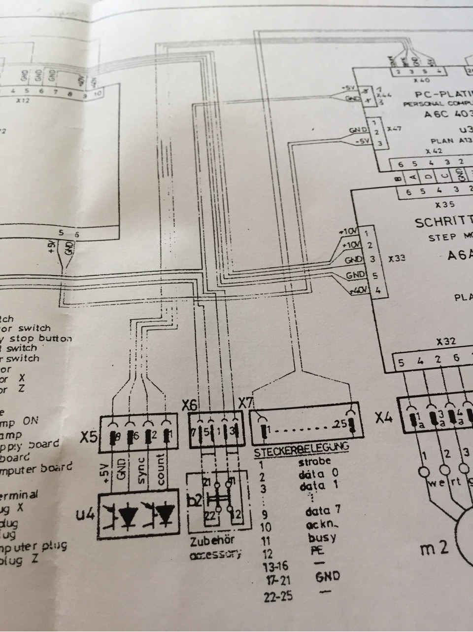

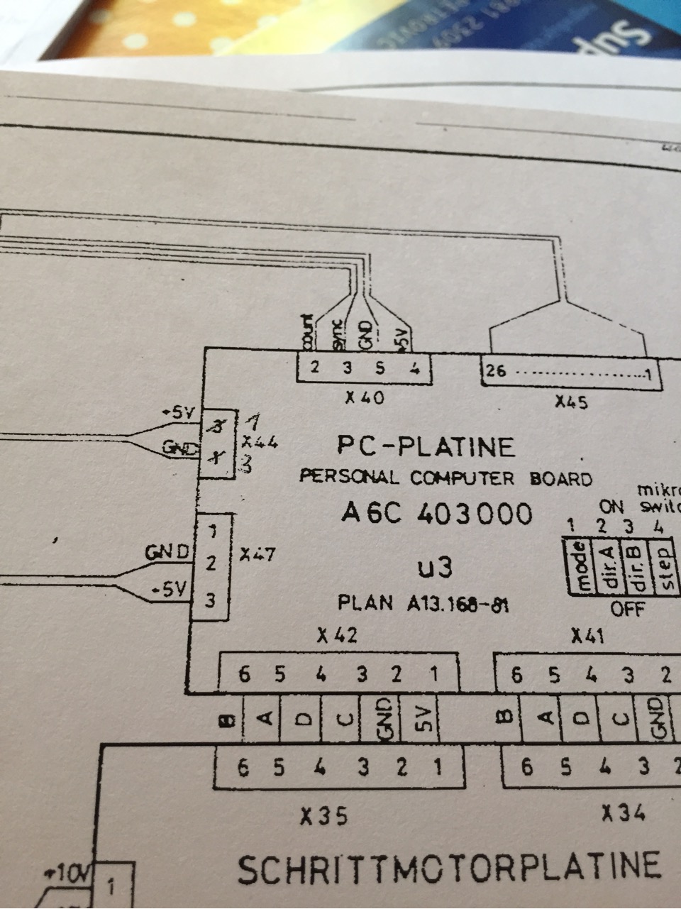

Unfortenatley, I cant see them anywhere. But here are the shematics.

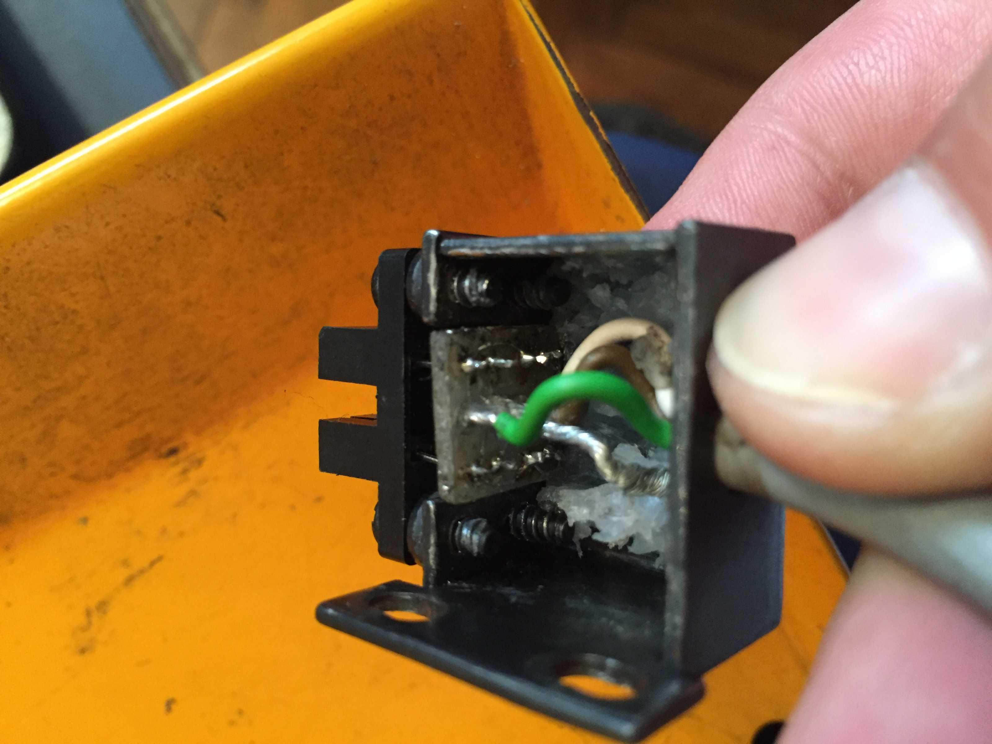

Can you see any current-limiting resistors on the little PCB in the sensor-box?
Are the LEDs wired in series or parallel?
If the measured voltage at the sensor-box end of the 5V wire is less than 5V then that would tend to suggest that there is current limiting in the supply. If it is a full 5V then is sounds like the current limiting is in the sensor-box or in the devices themselves.

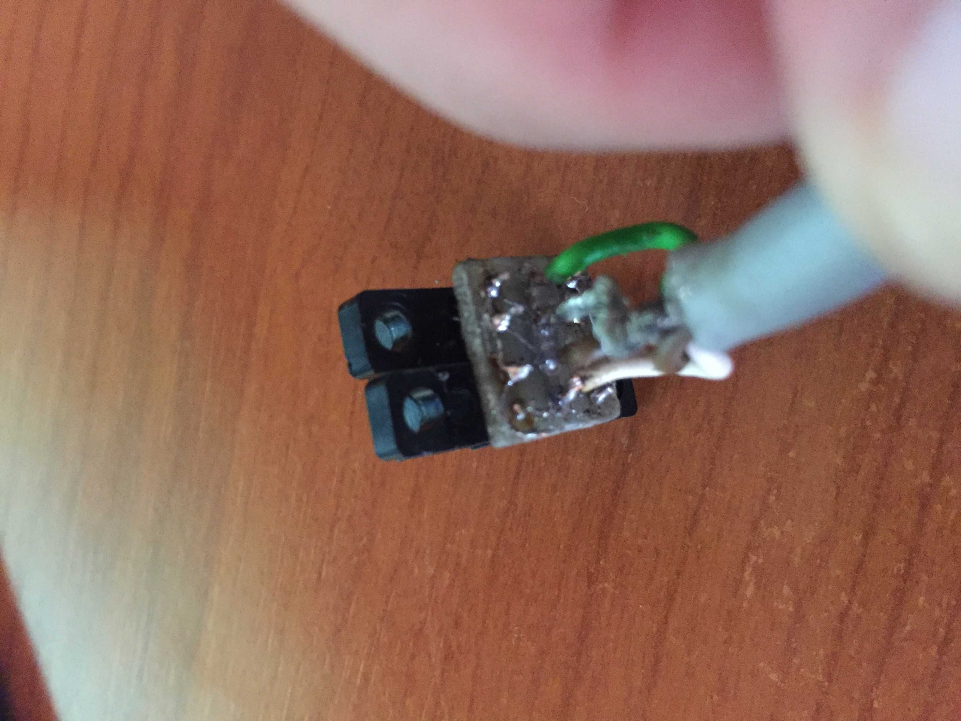

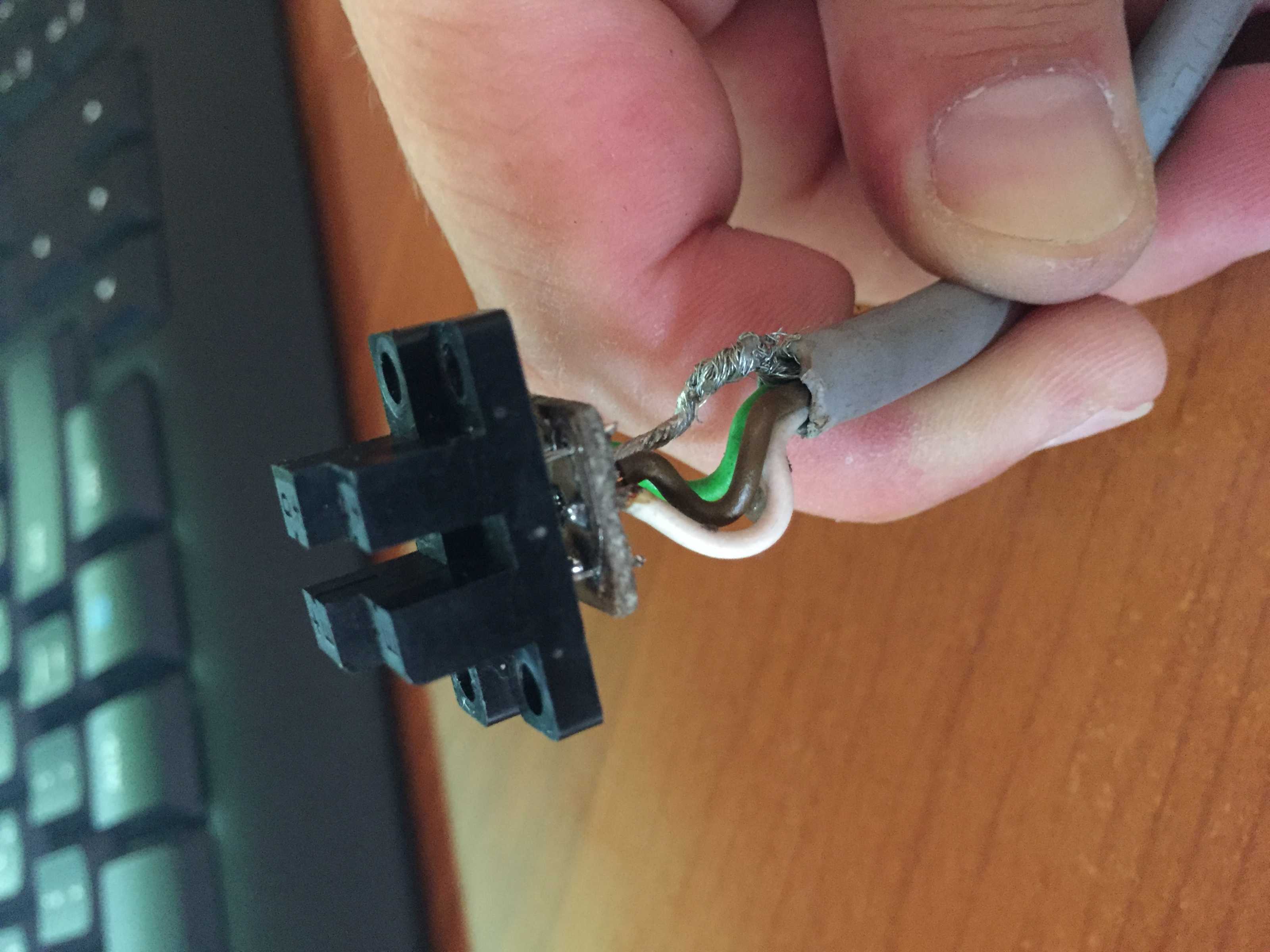

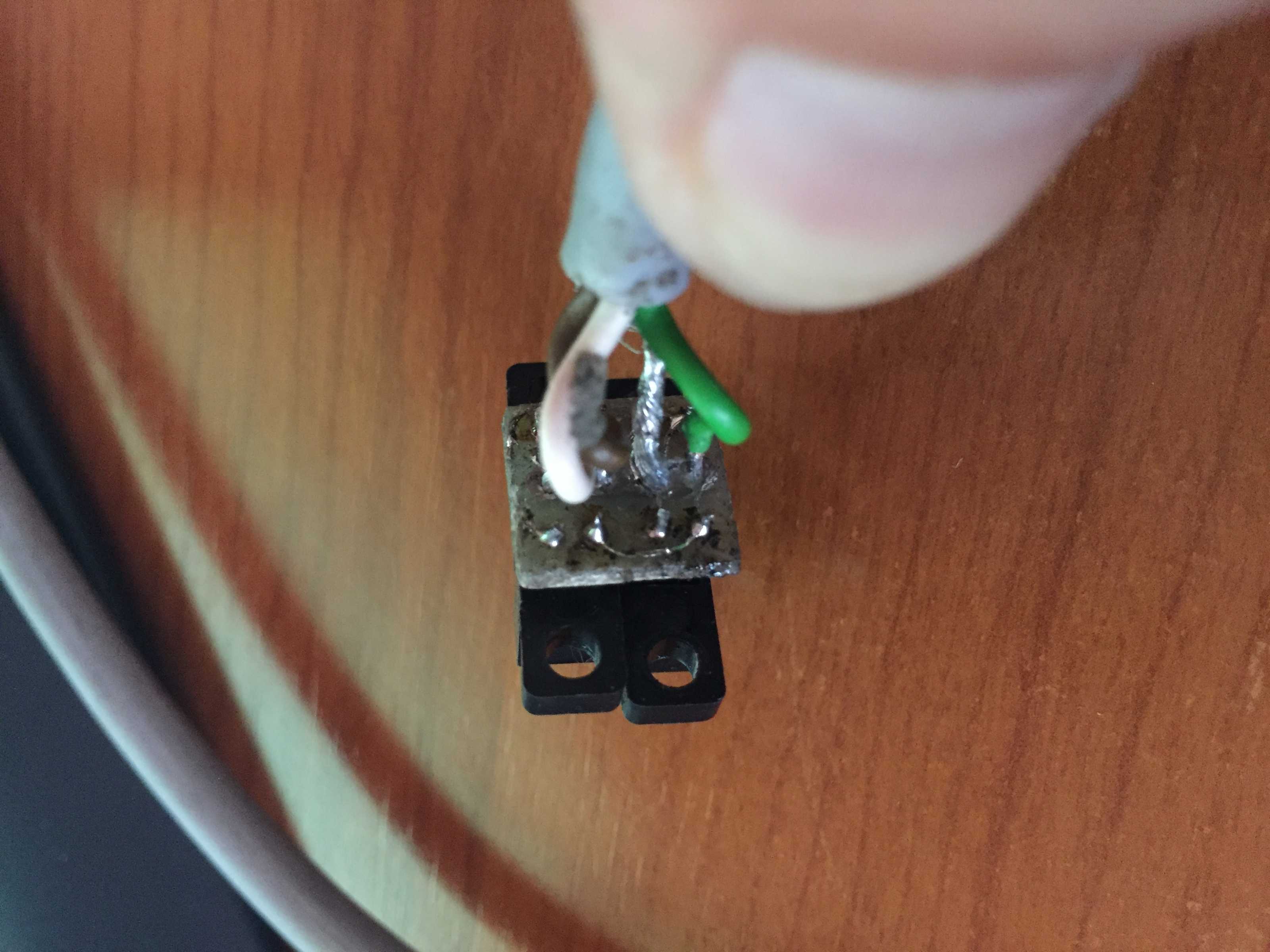

Stupido me, I brought it home, and I forgot that I dont have power source here to take any kind of measurements.
Better photos are included, but its not likely that they will be too much help?

You should be able to figure out if the LEDs are wired series or parallel.
If you had a bench PSU you could see what voltage the LEDs take to reach 20mA. That would hint whether the Optos were 5V devices or not.

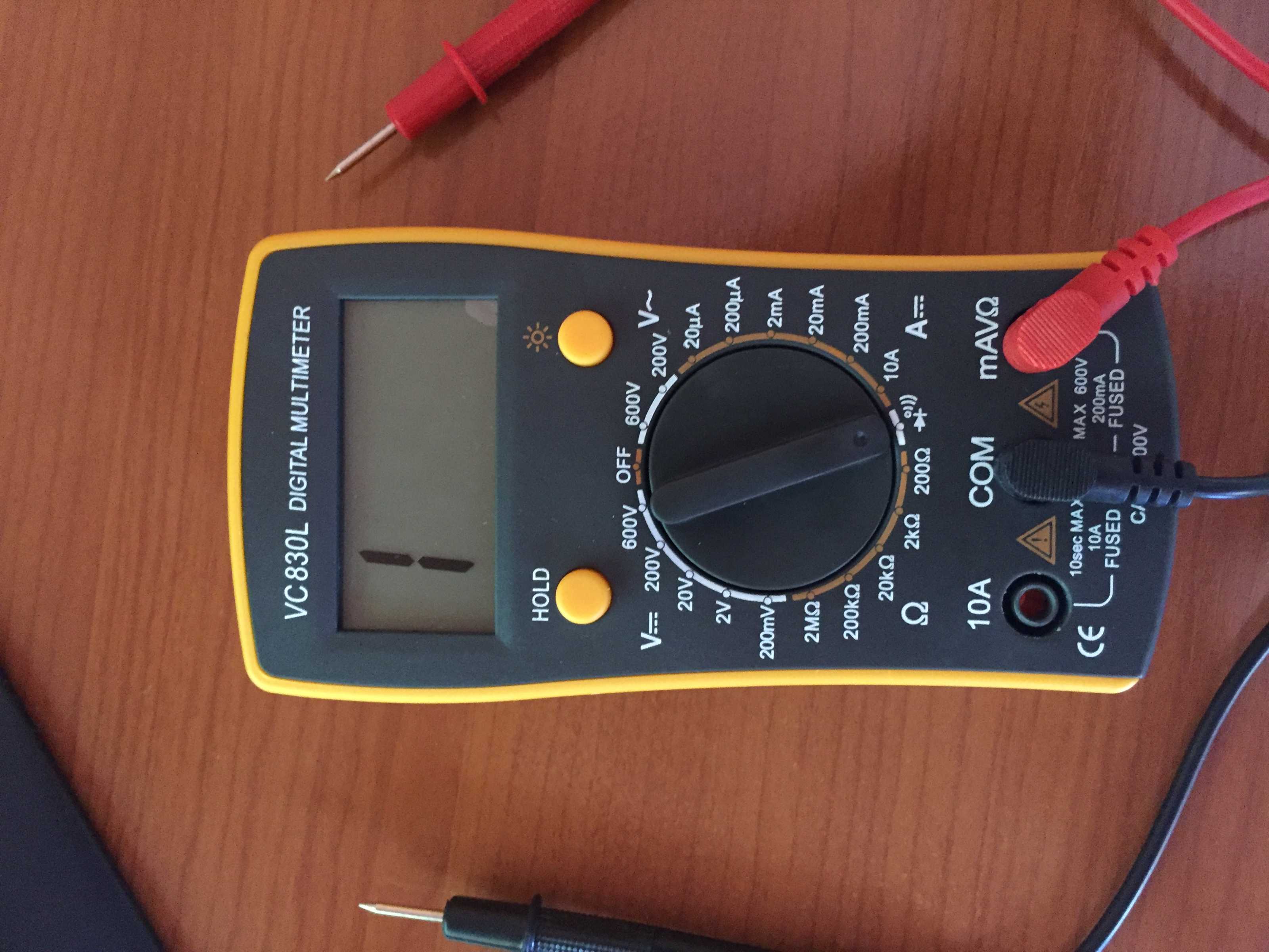

Actually, it probably does help. What does your multimeter read in diode-check mode on the LEDs (test both ways round).

OK, its fiddly to touch and measure right now. When I put multimeter to 200 ohms, and somehow touch all 4 pins of the forward (higher LED) I get a 1.5 reading. When in diode check, I get 001 on display (when not touching anything it reads 1 but in the opposite corner). I ll dismantle it again to check the other
