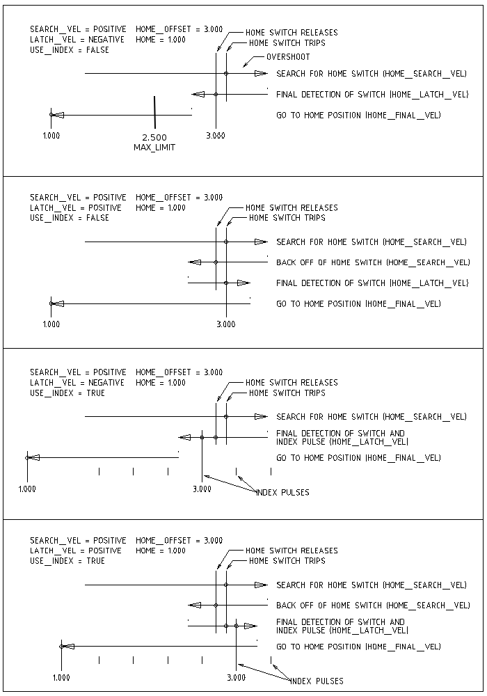

In case others would like an explanation of what happens:
When homing is commanded:
1. Moves towards the home (limit) switch at 10units/sec (HOME_SEARCH_VEL) until switch triggers
2. Moves away from home switch at 0.25units/sec (HOME_LATCH_VEL, note the minus to command a negative move) until the switch releases.
3. This position is set to HOME_OFFSET. That is, when the switch releases, that position on the axis is now called 1mm (in my case), defining where the axis travel / scale is in relation to the home switch.
4. The machine moves to HOME - which is just within the soft travel limits.
The manual needs clarification and more information about the relationship between MIN_LIMIT, MAX_LIMIT, HOME, HOME_OFFSET
The diagrams are good, but should included a reference to MAX_LIMIT to clarify things.
I suspect the note is really meant to be about HOME, not HOME_OFFSET. If you try to have a HOME position that is not between MIN_LIMIT and MAX_LIMIT, you get errors.

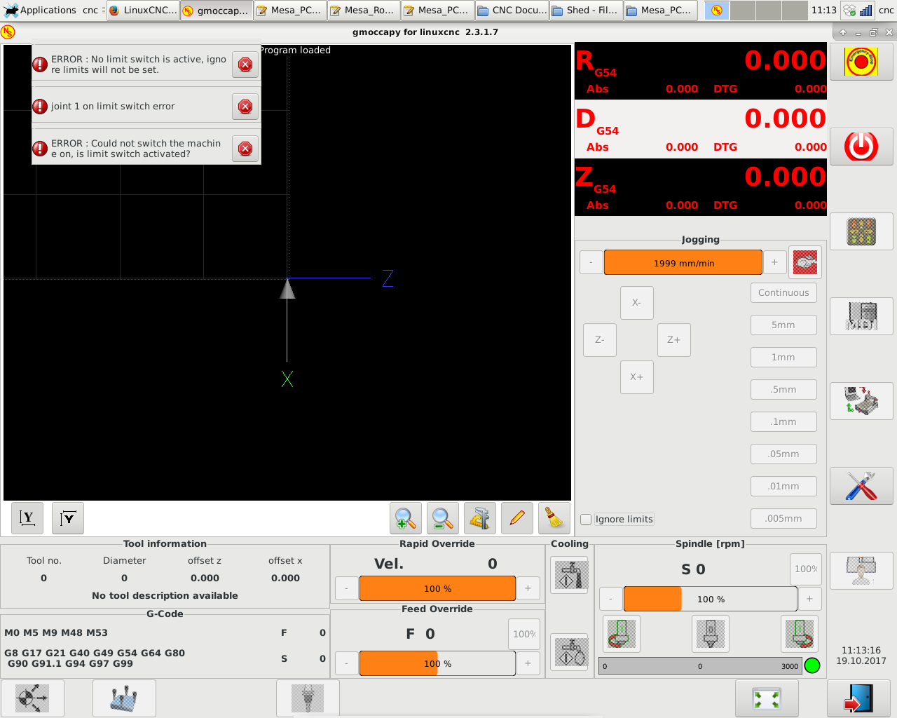

On another note, I think there is a bug (potentially in gmoccapy), which was not letting me use the override limits to jog off a limit switch.
The machine is on a limit switch (giving "joint 1 on limit switch error")
The override limits check box is available. When I try to check the override box, the error "No limit switch is active, ignore limits will not be set". Therefore I can't enable the machine to jog it off the limit switch!

12 Mar 2020 06:07 #159845 by cmorley
3.6. HOME_OFFSET
Contains the location of the home switch or index pulse, in joint coordinates. It can also be treated as the distance between the point where the switch or index pulse is latched and the zero point of the joint. After detecting the index pulse, LinuxCNC sets the joint coordinate of the current point to HOME_OFFSET. The default value is zero.
Note - The home switch location, as indicated by the HOME_OFFSET variable, must be strictly within the soft limits. That is, MIN_LIMIT < HOME_OFFSET < MAX_LIMIT.
It doesn't say the home switch must be within soft limits (they must be within hard limits).
Home offset is the distance from the home switch to the machine origin.
_Machine origin_ must be inside the soft limits.

12 Mar 2020 07:12 - 12 Mar 2020 07:13 #159850 by rodw
I really think that these instructions are correct but it takes a while to get your head around the process. I found it was perfectly clear when I Built my machine but:
1. Hard limits by definition have to sit outside of soft limits. They should never be hit. Stuff breaks.
2. Limit switches need to be inside the hard limits far enough to allow the axis to coast to a stop before crashing into the hard limits. I found things stop pretty quickly
3. Soft limits need to be inside your limit switches so the switches are never triggered.
4. Home switches need to be inside limit switches (and soft limits) and must allow enough room to coast to a stop as the deceleration is very gentle during homing for maximum accuracy.
You can ignore limits (typical case is shared home/limit switches) but after homing, you must use a home offset to move the axis off the limit switch or it will trigger the limit as soon as it comes out of homing.
So from my experience, shared home/limit eats into machine travel. My home switches are about 45 mm inside the limit switches to allow the table to coast under homing, then I use a home offset to move it as close to the limit switch as I can to maximise travel.
Also you must be careful to read the right instructions. The OP said he was using master. The home offset is covered under para 3.7
linuxcnc.org/docs/devel/html/config/ini-...ng.html#_home_offset
But Chris quoted another version where the para was 3.6 so take care.
In my view if you have enough inputs (and enough room for the switches) having separate max limits, min limits and home switches is the way to go, particularly with gantry machines
