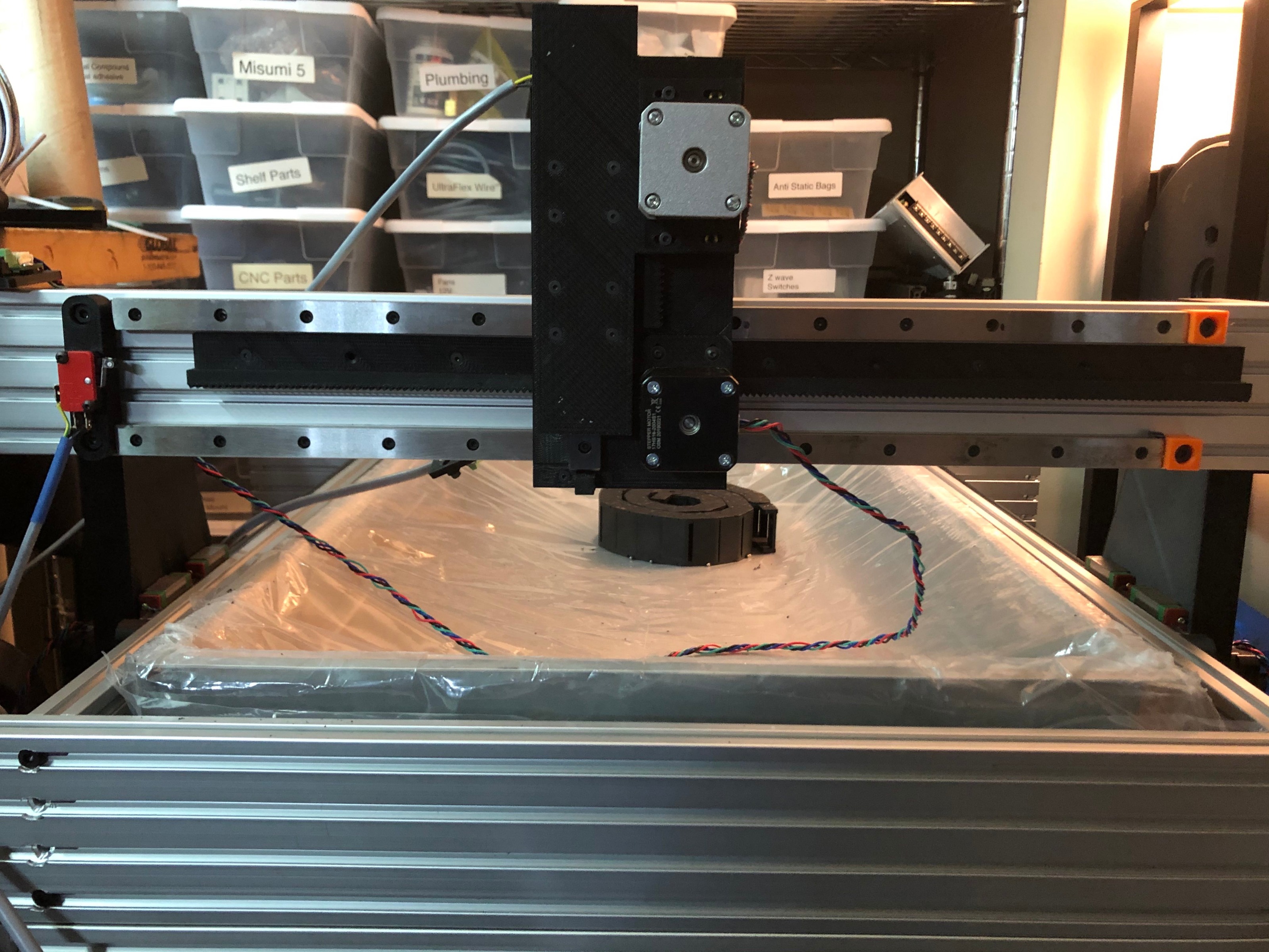

13 Mar 2020 01:13 #159974 by calvin.d
yes, I am absolutely losing 3mm of travel with the way the config is
if I just have a home/min limit switch I had assumed (probably bad on my part) that I would not want to be able to get too close to the limit switch during travel, which means I need to "lose" some amount of travel. I looked at it as the overrun space.
the link is super helpful
Hard-limits = physical end stops in my case (the orange bits stop the bearing blocks from coming off the rails)
