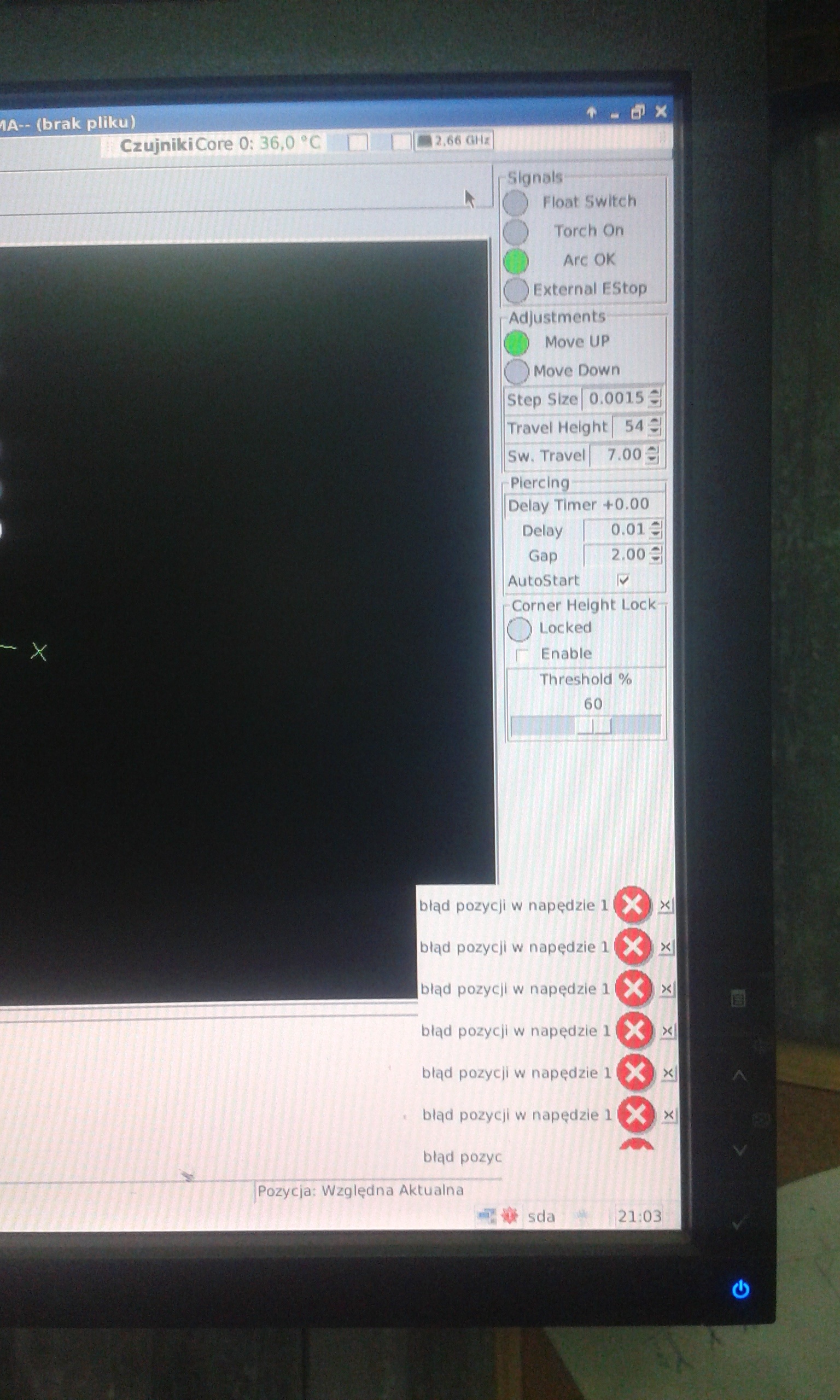

I have some information from Prokopcio about connection Myplasm (150 mode) to my mainboard. I connect UP DOWN ARCOK to Pin 10 Pin 11 Pin 12. Now i don't already have floating switch (i have switch but torch is too heavy and i must build something new).
I don't have estop or any limit switch.
How can i test THC?
I think i do something wrong when I edit hal file.
What I do?
First i download files from here: proma-elektronika.com/index.php/pl/porady/plasma-thc-linuxcnc
Next I try to run this, and on my screen i see Linuxcnc and in the right i see THC panel.
F1 doesn't work. I think "maybe estop?" I search something about estop and delete it. Ok now i can run F1, and F2.
Next I edit hal file "parport" and now when I try move something I see Drive error.

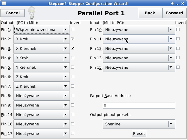

Pin config from Stepconf is here:
How can i test THC?
What I do?

Maybe thc-toma config is not for my machine? I can't change pins in my machine...
Pin 1 relay (turn on torch)
Pin 2 - 7 driver
Pin 10-Pin 13 Up Down Arc OK...
Pin 14 relay
What can I do else? I have 10 sheet 2mm and i can't cut this... is too hot ;/
Pin 2 - 7 driver
Pin 14 relay

I do all again. Now i can use F1 but when why try F2 i see "drive in emergency switch". I delete one line in thc.hal and now i can use F2. I can move Z. When i try X or Y i see "driver problem". But when I set the speed <1200mm/min i can move X and Y. Next small problem is revert X. I try something like this:
net StepX stepgen.0.step => parport.0.pin-02-out-invert 1
net StepY stepgen.1.step => parport.0.pin-04-out
net StepZ stepgen.2.step => parport.0.pin-06-out
net DirX stepgen.0.dir => parport.0.pin-03-out-invert 1
net DirY stepgen.1.dir => parport.0.pin-05-out
net DirZ stepgen.2.dir => parport.0.pin-07-out
I try connect the pin 13 (floating switch) and i do not see anything in LinuxCNC. All wires is ok because when I try to use stepconf and assign pin 13 to estop i can use that without problem.
Thanks for help.
If we made it and all will be ok can I use this without floating switch?
Thanks for help.

Now already work! All the time I must learn... I have only two problems. First: i have velocity 100 but speed more than 800 have error... Second is something differrent. When I have too curve plate and move X and Y axis i switch on floating switch. (without burning). What can i do to move torch to up? (floating switch is on and i can't do anything).

23 Feb 2018 16:17 #106399
Replied by tommylight on topic Zelrp + Linuxcnc 2.7.12 + THC 150
On the left side there is "ignore limit switch" or similar, click on that and press F2, now you can move torch up,.
