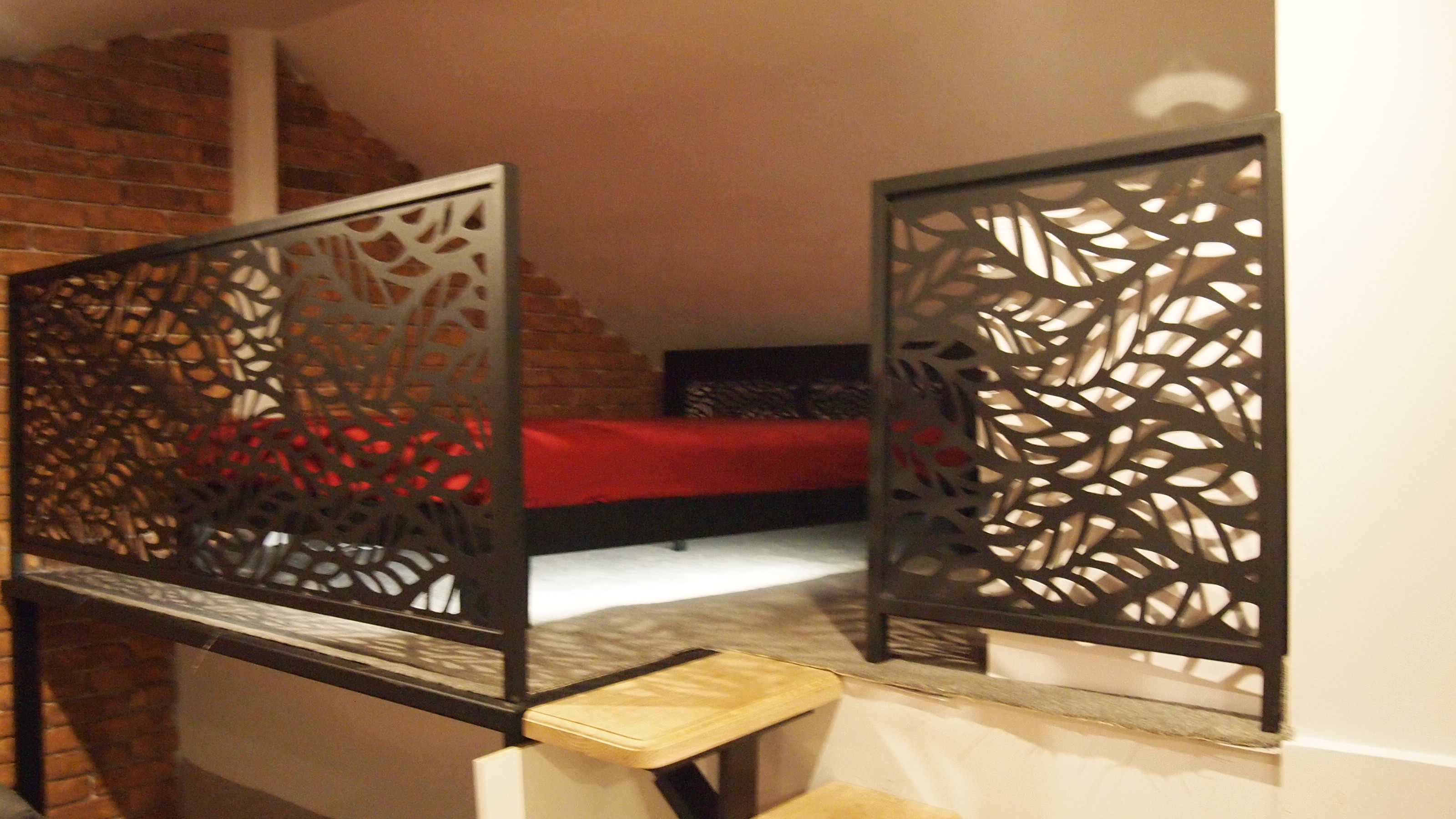

Hello again!
I have last two questions. First: how can I change default step size and gap? And second what can I do to have sharper corners?

21 Mar 2018 20:51 #107696
by dyzio215
Replied by dyzio215 on topic Zelrp + Linuxcnc 2.7.12 + THC 150
- Posts: 22002
- Thank you received: 7488
21 Mar 2018 22:04 #107703
Replied by tommylight on topic Zelrp + Linuxcnc 2.7.12 + THC 150
That is niceeeeeeeeeeeee.
The result makes up for the trouble, for sure.
