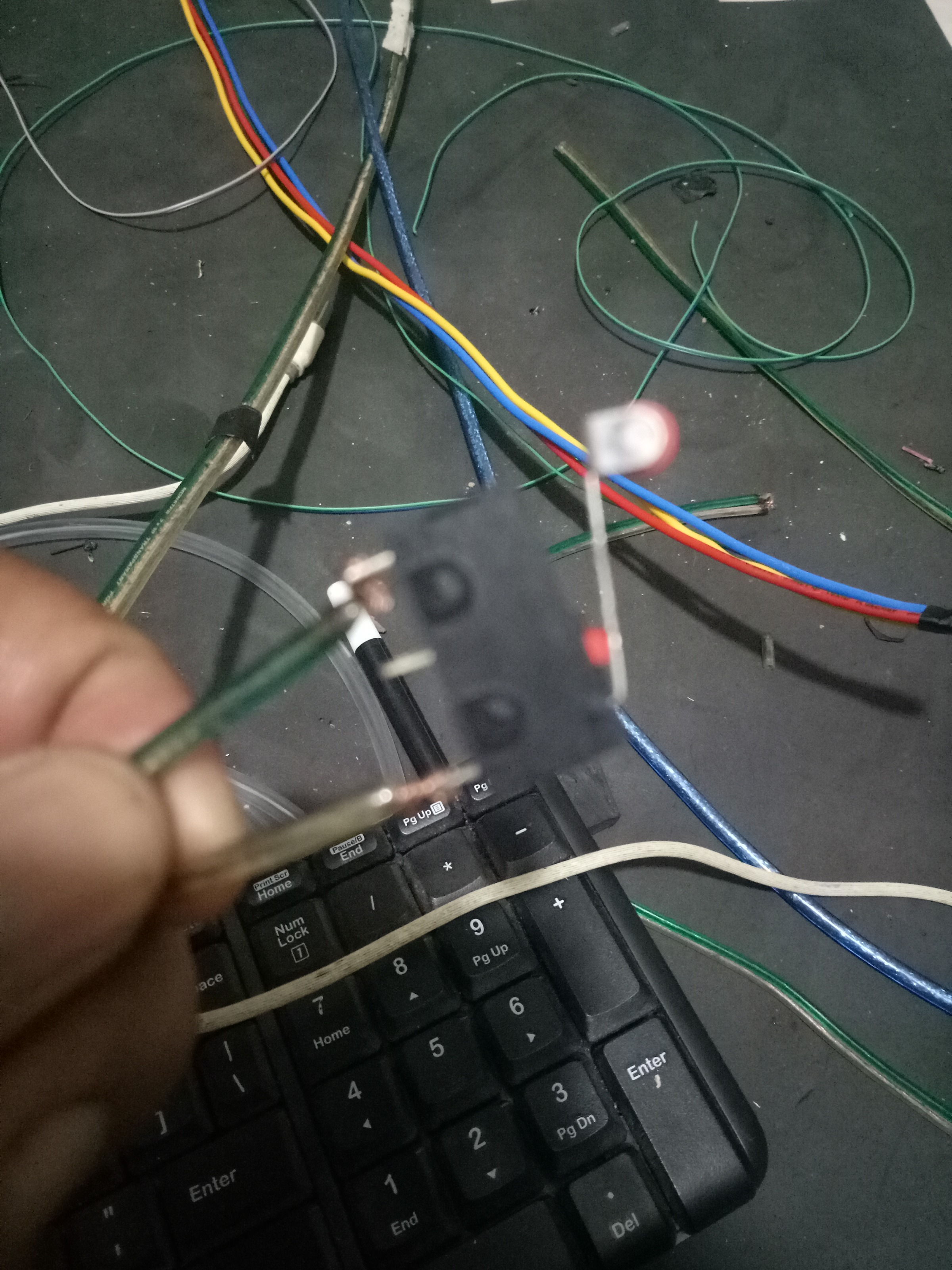

01 Jan 2021 09:01 #193727
by Trihwangyudi1990
Replied by Trihwangyudi1990 on topic Home all not working
I have an error when setup limit switch.. All axis doesnt send signal to my BOB...
When i try to homing its dosnt work... I check the hal meter and its not happen anythings...
My limit switch is NPN
Then i try with just limit only in section stepconnf and its dosnt work
I'm wiring with NO,change to NC (com to gnd) its not work

01 Jan 2021 09:06 #193728
Replied by tommylight on topic Home all not working
What BOB?
Did you try to invert the input in stepconf ?

01 Jan 2021 09:09 #193729
by Clive S
What bob are you using. If it is the common China one with a relay on it. Then have you connected 12-24 V power to the terminals near the relay. The inputs won't work without it.
Replied by Clive S on topic Home all not working

01 Jan 2021 09:11 #193730
by Trihwangyudi1990
Chinese (BOB) Break out board
Yes i try invert the checklis box..buts its dosnt effect...
Or maybe i must eddit hal file to activate limits switch signal...??
