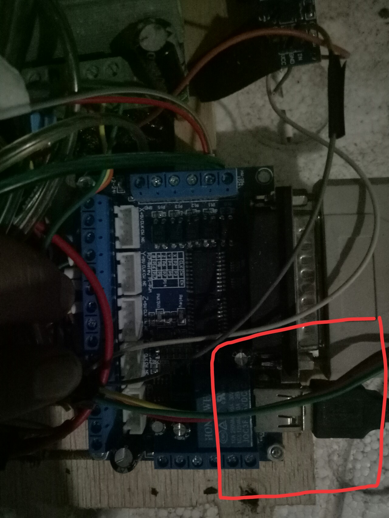

Yes i try invert the checklis box..buts its dosnt effect...
Or maybe i must eddit hal file to activate limits switch signal...??
Have you got power as above. Also you are double posting

Yess its common chinese i have, i connected the power source from usb port with my cpu.. The steeper motor work smothly but when hits the limit switch the motor still run and dosnt stop..
Or its my wiring for sample
I conected NO pin with pin 10 and com pin with gnd..

You still not have answered the question . Have you applied power 12-24v to the bob as the inputs won't work without it.
Post a picture of the bob's wiring

Sorry for my miss this the picture my be i need add the source??

Those BOBs require both 5V power (from USB in your case)
_and_ 12/24V power for the inputs and spindle control
The inputs will not work without the 12/24V power

I say yet again you need 12V power to the middle 2 pins as well as 5V usb

Thanks all.. Its solved...
Yess its need add power source
