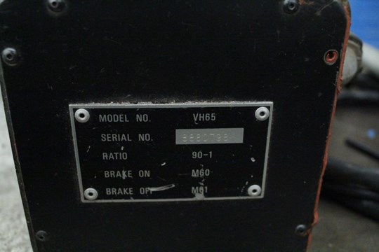

The problem I'm running in to is I can't seem to find the specs on the VH65. It seems to be a very popular rotary, but more as a direct drop-in on the fadals that come pre-wired for them. The data plate has nothing on the specs. I'll probably pop open the cover and see if there's a tag on the motor itself.

That's not the motor or the motor name plate (that is the nameplate for whole rotary unit.)
I think the motor would be inside that box. (But I have no idea what snakes you may find in there.)

The data tag I posted earlier in this thread confirms it's a 90:1 ratio.

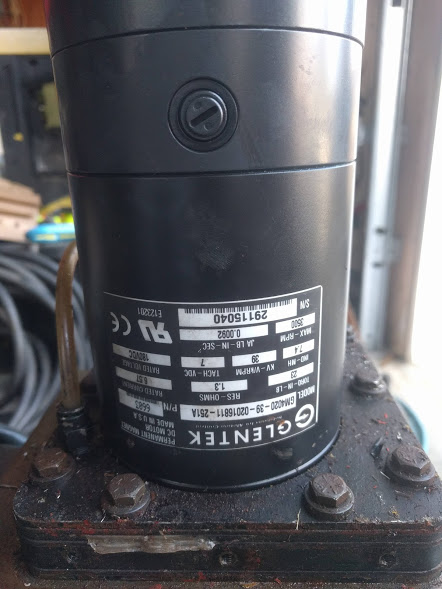

I actually pulled the motor cover over the weekend and found what appears to be a very new Glentek motor. I don't love the wire splicing job I found, but that can be cleaned up.
My plan is to test the motor and hopefully encoder before I go too deep in this. Since this is DC, I'm assuming I can feed something like 12v DC directly to the motor leads to at least test it for motion?

I've verified that the motor is good by putting 12vdc to it. I believe it was brand new.
