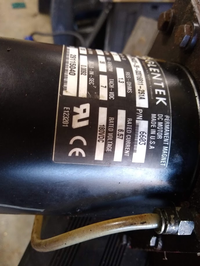

Question: What do you mean by "rectified 110VAC mains"? Or at least the rectified part?
Reading through the data for the drive, all I'm seeing under power requirements is "24-180VDC Transformer isolated from power mains" I was under the assumption I'd need a DC power supply to feed this thing.
I assume if I ever wanted to get the max speed out of the motor, I'd need to have a 180vdc power supply feeding it? (Not sure if I'd ever actually need this, but who knows?)

Do you know what a rectifier is? It is one of the moast basic forms of AC to DC conversion, add a couple of appropriately sized capacitors and you have a simple linear power-supply.

23 Nov 2019 11:26 #151034
It's pretty easy to make an unregulated DC power supply.
Mains in -> bridge rectifier -> suitable smoothing capacitors.
Your manual seems to be suggesting an isolation transformer:
Mains in -> 1:1 isolation transformer -> bridge rectifier -> smoothing caps.
110V AC will rectify to about 150V DC.
If this is not something that you feel comfortable with then the suggested AC-input drive (or similar) looks like the way to go.

This isn’t goint to be plug and play... you are using a rotary table intended for a specific machine.
If you use a drive with a built in dc supply and you run it from 110v ac mains, you will end up with 150 volts of dc, that is a 90 volt motor, you will have to scale the input signal by by about 40%. the drive you select will have to be able to tolerate 150v of dc. AMC drives are sized by current /voltage. A 25a20 will push up to 25 amps of 200v dc. On a dc brush motor( and this may apply to brushless also, I don’t know) , motor speed is relative to voltage. If you call Fadal or Rotary Design( they are what is left of the Fadal brothers), they can give you a pin out for the cannon plug on the end of the cable . The plug isnt cheap....

The motor is 180v.
The pinout on the plug should be easy enough - it's only 6 wires and two of those are motor power. Haven't looked too hard for the wiring, but I'll be shocked if it's not readily available. Should be easy enough.

Motor is rated at 180v. I’ll double check on mine tomrw, but I’m about positive that Fadal used a 90 volt supply, as 90 vdc was vey popular for dc motors in cnc machines of that era. Fadal stopped with dc motors in 1996 or 1997. The motor may have been able to move at 100% voltage, but my guess is the Fadal control of the era couldn’t accurately track motion at that speed, the early Fadal control had poor jerk control and acceleration and deceleration control.
