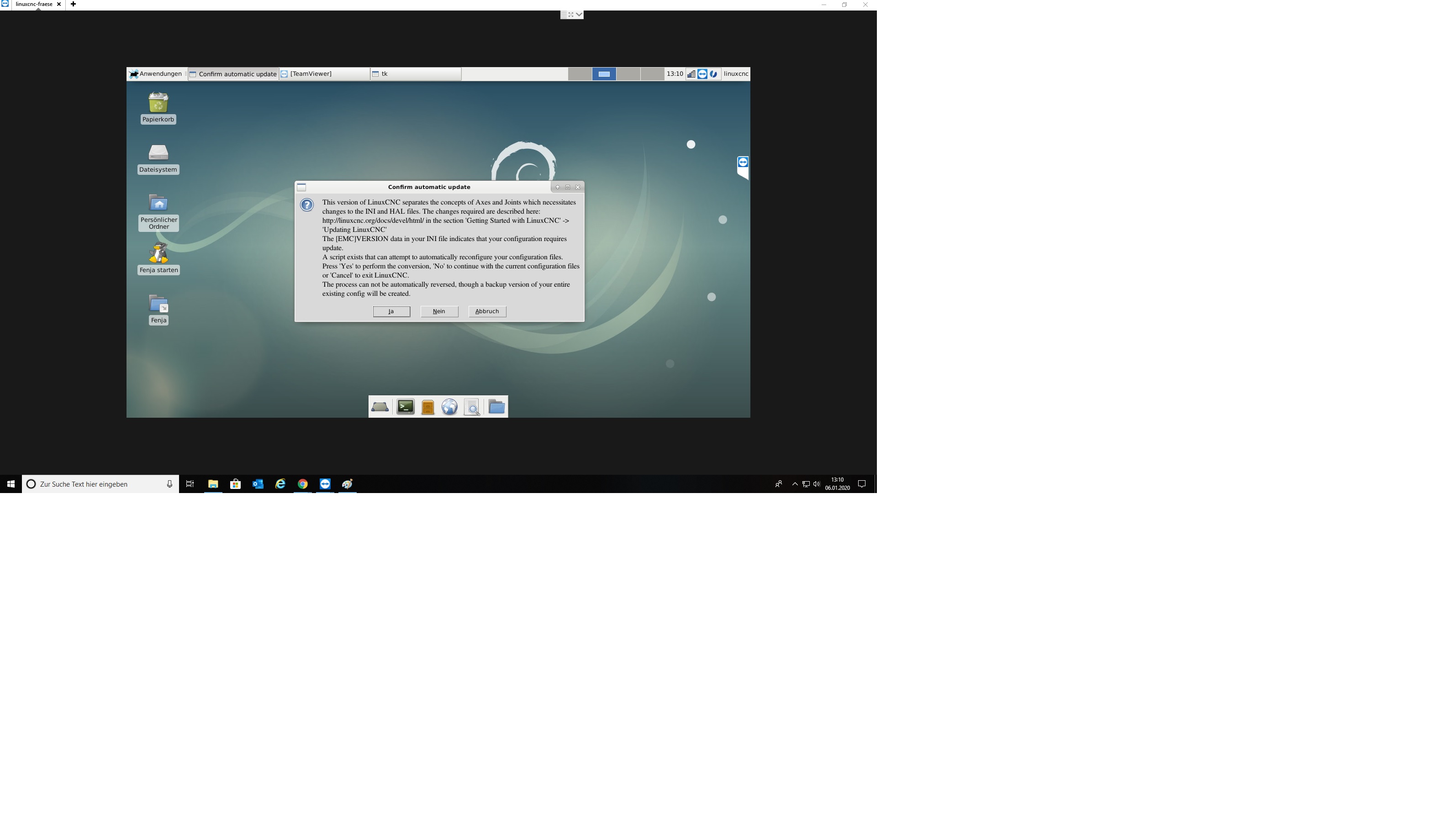

06 Jan 2020 12:22 #154141
by DC67
Replied by DC67 on topic Linuxcnc always wants to update my INI file
hello
i changed my ini file because i want to use probe screen v2 with gmoccappy. now i always get a message at linuxcnc start (picture) i have been using v2.8 for a while without any problems and the update that he suggests doesn't work. if I click no then everything goes on normally. what am I doing wrong here?

06 Jan 2020 18:04 #154161
by Mike_Eitel
Replied by Mike_Eitel on topic Linuxcnc always wants to update my INI file
I think Version 1.1 must be adapted. A while agoo there was something about it here on the forum

09 Jan 2020 00:34 #154369
Replied by andypugh on topic Linuxcnc always wants to update my INI file
Is this fixed?
