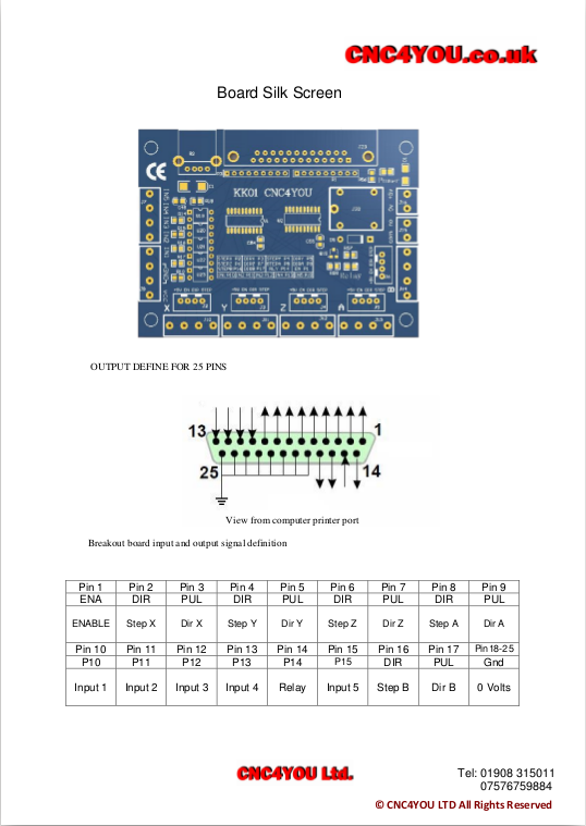

Please, can some one tell me how to add the rotary axis to to the attached hal and ini files. I have also attached pin assignment diagram. I have looked at these files in gedit but cannot understand what is wrong. I can home and jog the X Y and Z axis but the rotary stepper has no power to it.
Thanks.
Thanks.

On some of those Chinese breakout boards when you use the spindle speed feature you lose the 5th axis control. You might be able to reassign some but I'm not sure. It may have a jumperthat needs to move also

- Posts: 19902
08 Jan 2020 16:02 #154352
Replied by andypugh on topic configuring a rotary axis on a CNC Rrouter
Copy and paste error:
You reset pin 04 twice, and pin 16 never.
It might not be that, though.
net ystep => parport.0.pin-04-out
setp parport.0.pin-04-out-reset 1
net ydir => parport.0.pin-05-out
net zstep => parport.0.pin-06-out
setp parport.0.pin-06-out-reset 1
net zdir => parport.0.pin-07-out
net x2step => parport.0.pin-08-out
setp parport.0.pin-08-out-reset 1
net x2dir => parport.0.pin-09-out
net home-x <= parport.0.pin-10-in
net home-y <= parport.0.pin-11-in
net home-z <= parport.0.pin-12-in
net home-x2 <= parport.0.pin-13-in
net estop-ext <= parport.0.pin-15-in
net astep => parport.0.pin-16-out
net adir => parport.0.pin-17-out
setp parport.0.pin-04-out-reset 1You reset pin 04 twice, and pin 16 never.

09 Jan 2020 05:29 #154427
by aaron
Replied by aaron on topic configuring a rotary axis on a CNC Rrouter
andypugh
Thank you very much. That did the trick.
