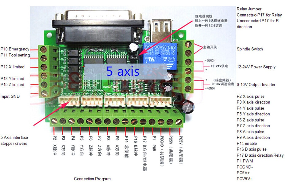

Aha, then your pin assignments are wrong.
This is what you have in "Router.hal" Lines 42 to 63:
Your BOB wants the PWM (Spindle speed) signal on Pin1 so you need to assign the signal "spindle-pwm" to pin1.
So do this:
change line 42 to:
change line 58 to:
Save and run.

net home-y <= parport.0.pin-13-inYour BOB wants the PWM (Spindle speed) signal on Pin1 so you need to assign the signal "spindle-pwm" to pin1.
So do this:
change line 42 to:
net estop-out => parport.0.pin-16-outchange line 58 to:
net spindle-pwm => parport.0.pin-01-outSave and run.

Followed instructions and now GUI works as it should be with now being able to use probe.
Unfortunately I have made very heavy weather with controlling the spindle. I had previously manually switched it off/on from the inverter but that alluded it. Not something I spend a lot of time on but eventually enabled it to switch off and on manually. Programmed off/on via PWM connection and although I get a change in voltage up to about 4 volts nothing happens. Something silly (XSY-AT1-2200X)

Well the PWM is not really meant to switch the spindle on and off. The pwm is for controlling the spindle speed by way of the 0-10V analog output. Spindle on/off is by way of the "Spindle Switch" relay contact on your BOB. And that in turn is controlled through Pin 17 if the Jumper on the BOB is in place. I'll have to check about the connection in Router.hal...
[edit]
So this is not correct.
replace with:
Then of course you will have to wire the vfd up correctly and probably also set the parameters accordingly.
net xenable => parport.0.pin-17-out
replace with:
net spindle-on => parport.0.pin-17-out

I have a fault report to say net spindle-on => parport.0.pin-17-out this action already done so I will comment out

\Now able to switch spindle manually off/on through GUI or by running a programme. Hopefully I will be able to vary the speed also, but that is a task for another day.
