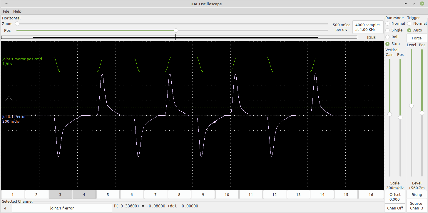

03 Apr 2021 05:18 - 03 Apr 2021 10:22 #204605
by Muzzer
Replied by Muzzer on topic Closing the loop with linear encoders
Hi Andy - I spent a couple of hours yesterday playing with both the X and Z axis tuning, using the config tool and Halscope. The MPG seems to be a convenient means of providing step inputs to the axes.
I started off with the X axis which is a simpler assembly, turning up P from 1 until it started to oscillate around 50, then backed it off to 30 and dialled in some D, trying to speed up the response without significant overshoot. I couldn't improve much on D=5. Finally, some I term. I couldn't see much improvement beyond I=0.2.
With the Z axis, I ended up with P=80, I=0.5 and D=20.
The response is hardly a textbook example of a well tuned servo system. I get a fairly rapid initial move, followed typically by a slower creep up to the final position. Given that P and D are about as high as they can go sensibly, I'm not seeing any great opportunity to improve on that. Ideally I'd be getting there mostly due to the P and D terms, with the I providing a last, steady state adjustment.
There's a lot going on in reality, so this isn't quite a simple mass spring damper type situation. There are 3 factors making life less than straightforward:
So I have 2 hysteretic elements (backlash and encoder resolution) and servo drives with questionable responses. I can feel a battle with the Lichuan servos coming on, otherwise I suspect I am close to what I can expect as a final result.
Given the 5um resolution of the encoders, what is the recommended deadband? I'm guessing somewhere between 2.5 and 5um but I can't figure out a convincing logical answer to that. Certainly, increasing the deadband towards the 5um (0.005) level seems to get rid of much of the grumbling / jittering that arises after some moves.
I seem to have inherited FF1=1, presumably from the original CNCconf setup. The other FF terms are zero. I did play with a couple of them and it didn't end well, with the joint drifting out of position, so I left them as they were. I don't have any high frequency bursts going on but until I reread the docs, I'm not clear if I'm missing anything here.
Finally, how do the STEPGEN_MAXACCEL and STEPGEN_MAXVEL affect the PID behaviour? Presumably they will affect the slope of the rising edge of the demand step I'm using to observe the system response, which would in turn affect the effect of the D feedforward term for instance.
Here's what I have for the Z axis:
Incidentally, what should I specify for the following error? I have 300 at the moment but I'm not even sure of the units....
- The mechanisms both have a degree of backlash and although I've taken care to minimise them, they are of the same order as the movements I am trying to optimise ie ~+/-10-20um. I have reasonably good quality Korean ground ballscrews but the lathe itself (Colchester Bantam) has seen better days and the saddle is being driven some way from its centre of mass and the likely line of action of the cutting forces. The Z axis is less ideal than the X, not surprisingly, due to the vee and flat ways and larger mass.
- The encoders have "5um" resolution, so realistically I can't expect to control position much better than somewhere in the region of +/- 5-10um surely.
- The Lichuan servo drives will be a pig to try to tune. The absolute first thing to do in a dual control loop system like this would surely be to get the servos as optimised as possible before playing with the external (LinuxCNC) loop. However, the tuning "software" is no more than a means of downloading and uploading the table of parameters from a PC to the drives and I don't seem to be alone in being unable to even load the "software" on a W10 machine. So I've started out with the standard tune, which I suspect is pretty ropey and must be limiting what I can do.
EDIT - finally got into the Lichuan "software". On my 4th Windows 10 machine, I finally got an installation that actually worked - and spoke English. Then installed the driver for the USB-RS485 serial device and uploaded the parameters from one of the servo drivers. The anticlimax moment came when I saw that the only parameter I can set is the direct P term, which is set to 20. I suppose that simplifies life but I'd hoped for a bit more opportunity for improvement.

- Posts: 19902
03 Apr 2021 11:03 #204633
If the PIF asks for a velocity that is > the MAX then it won't happen. So the PID will be asking for something that doesn't happen.
This should only happen when the PID is saturated, and in a well-behaved system that probably shouldn't happen.
You might want to cap the PID output to match the stepgen limit.
As you noted, the STEPGEN_MAXVEL will cap the D-term input.
Accel is more interesting, as it will delay the effect of the PID, causing a phase shift, which might be enough to cause resonance. But I don't think that there is a way ti internally cap the rate of change of PID output.
Replied by andypugh on topic Closing the loop with linear encoders

BTW - how do I arrive at a sensible value for the following error? Although I have it I set FERROR to 300(??!!) on the Z axis in my INI file, I can cause a follow error if I jog enthusiastically. It doesn't look as if it's actually being used anywhere in the HAL file. Should it be ending up in pid.z.maxerror? That seems to be hard wired at 12.7um if I understand it (and the units) correctly.
Presumably it should be
setp pid.z.maxerror [JOINT_1]FERROR?

There are two FERROR values. MIN_FERROR for low-speed error and FERROR for high speed.
linuxcnc.org/docs/2.8/html/config/ini-co...t__lt_num_gt_section
It should be small. It is the point at which the system is saying "I am no longer making the part you asked for"
Neither normally appear in HAL (though there is no problem with referencing the values for your own purposes). The motion module reads the values directly from the INI, in the same way as it reads the axis limits on position, velocity etc.

Thanks. I will leave the setp pid.z.maxerror 0.012700 alone and set the FERROR to something like 0.5 for the moment. Certainly that would seem more appropriate than 300.
