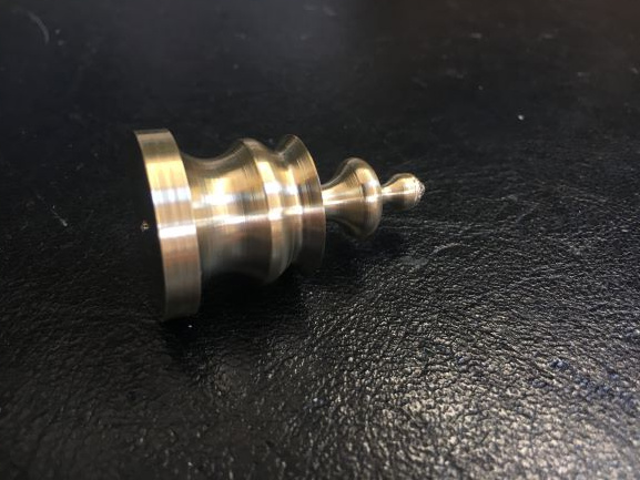

02 May 2021 16:43 #207684
by Muzzer
Replied by Muzzer on topic Closing the loop with linear encoders
I manage to machine my own version of the lathe pawn yesterday. One thing I noticed is that the Z axis motion was not very smooth - it seemed to be executing a series of steps rather than a continuous motion. With my calibrated eyeball and finger, I'd guess these are of the order of a few degrees of rotation of the 5mm ballscrew ie perhaps 100um or so steps. I have 846 steps per mm going to the servo if I understand correctly, so the resolution of the steps surely isn't the cause.
Could there be a mismatch between my PID tuning and the step gen perhaps - or a smoothing function / filter that I should be setting up? The behaviour seems to result in features on the machined part, not surprisingly. Can anyone see what's happening here?
Here's the relevant section in the INI file:
