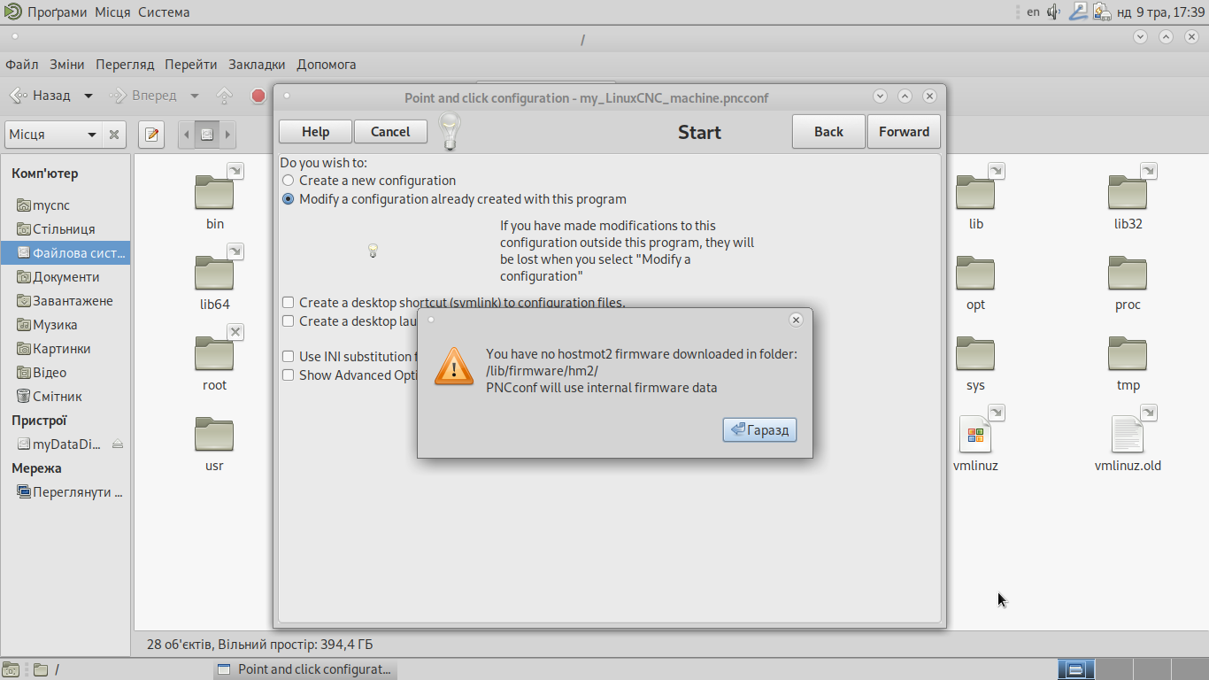

- connect my mesa 7i96 and make config at pncconf (I flash mesa card with 7i96dpl.bit, bu did it on old computer. I did not flash mesa card again on new computer. Hope it is OKAY)
I have table scheme XXYZ (i need two motors on x-axis because table quite wide 1750 mm).
I faced with two PROBLEM:
1) when I start to config pncconf I see message:
You have no hostmot2 firmware downloaded in folder: /lib/firmware/hm2/
PNCconf will use internal firmware data
How can I add that files and where I can find it?
2) I can not set X-axis motor working properly - they have to spin opposite direction but they don't(

1. You can ignore the pncconf warning
2. Did you invert the direction (not the step) pin?
You should have a statement in the hal file like:
setp [HMOT](CARD0).stepgen.0X.direction.invert_output true
In the tandem joint section of your hal file

I can not find such code in hal file. Please have a look by yourself
- ML
- Posts: 23
09 May 2021 10:39 - 09 May 2021 10:40 #208386
by ML
Replied by ML on topic Problem with 7i96 board connection “No 7i96 board found
Sorry, I found:
setp hm2_7i96.0.stepgen.02.step.invert_output true
but it is not direction(
