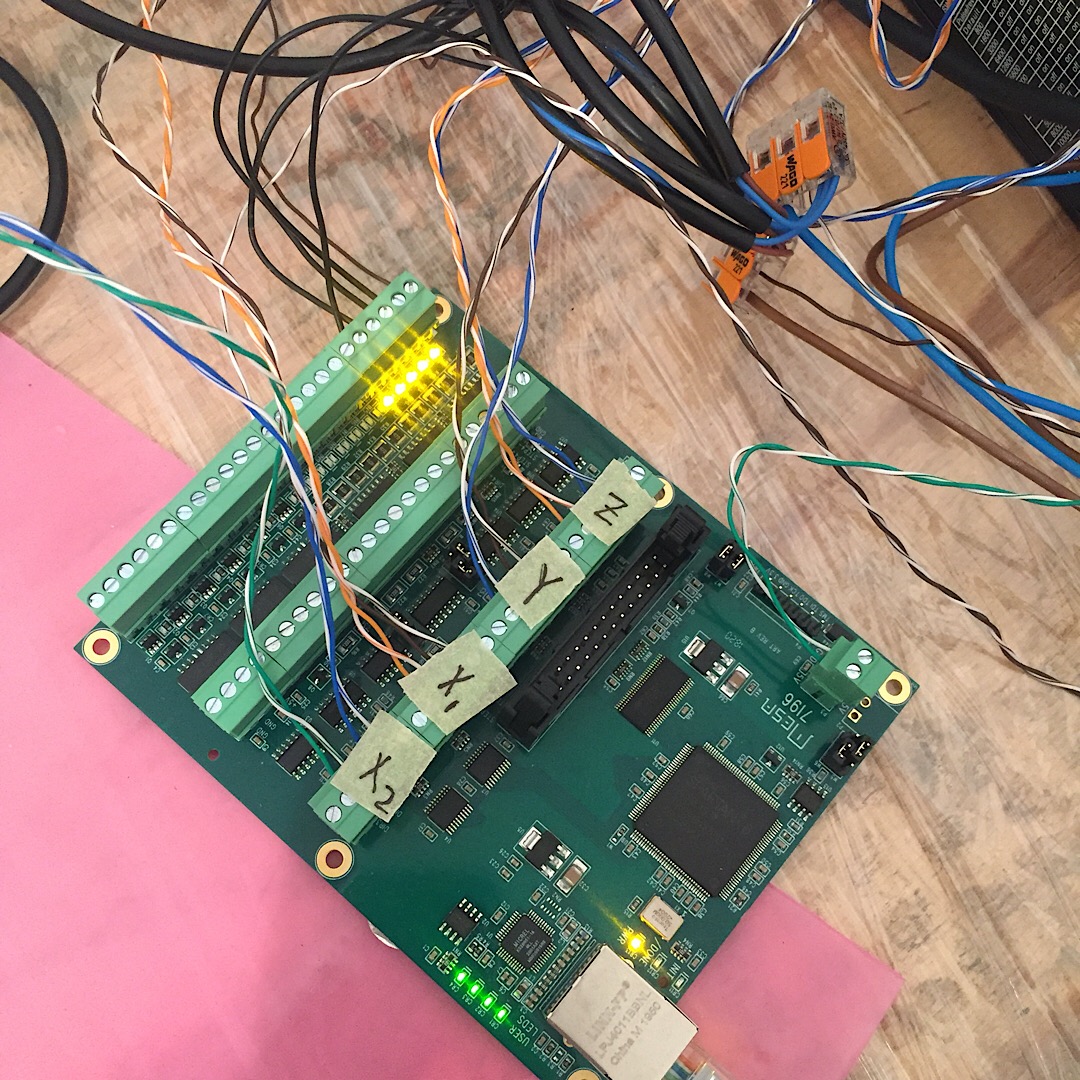

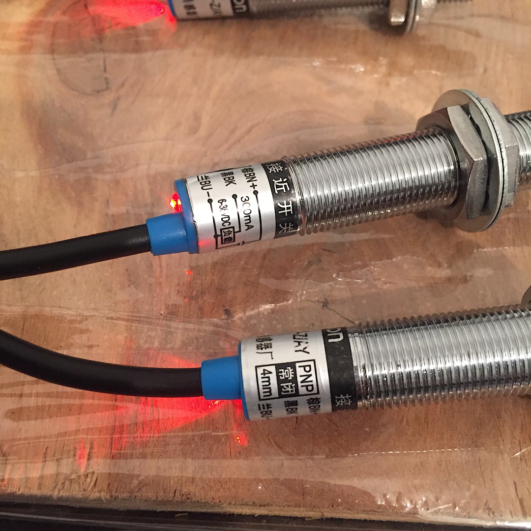

Good evening! Going forward with mesa. I have connected E-Stop (working properly), but can not understand how work with inductive switches (sensors).
I am using PNP NC with 12V power supply.
When I click home at Linuxcnc and touch switch with metal it doesn’t make homing. It homing when I touch (activate) sensors few times.
All LED at TB3 lights with yellow and blinking when I touch (activate) sensors.
How it works properly, how it set up?

15 May 2021 17:43 #208991
Replied by andypugh on topic Problem with 7i96 board connection “No 7i96 board found
It will probably work when the sensors are actually activated by the machine movement.
The homing sequence expects the sensors to change in response to the axis movement. Typically on / off / on again as the axis does the search, back-off and latch moves.
