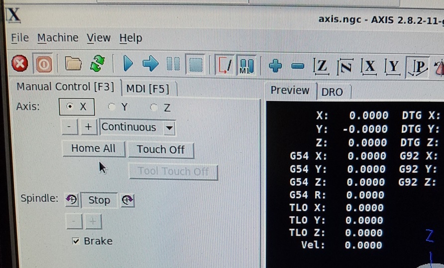

My table has no home or limit switches - I just zero G53 coordinates using homing and run programs from there.

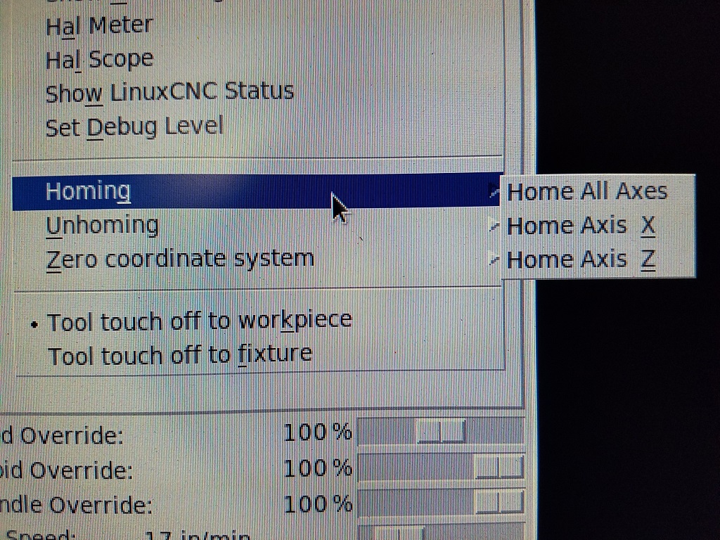

The homing menu entry in the Axis GUI under 2.8.2 is only showing me options to home all, home X, or home Z. No option to home Y. See attached pic.
Is this something I can force-enable in the config files (latest rendition attached for my laser setup)?

Replied by tommylight on topic no option to home just Y axis on gantry with 2 Y motors
You have home_sequence set to -2 for Y axis, hence it will only home if there are switches on both sides.
Most probably setting that to a positive value will work as you have it set for immediate homing.

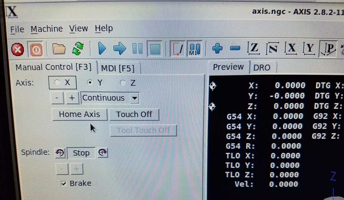

No luck. Tried them as both 0, both 1, both 2, and then one 2 and the other 3.
I also tried getting rid of the HOME_SEQUENCE lines, which changes the the Home All button to Home Axis (see attached screenshots and excerpt from documentation below), but when the Y axis radio button is selected, the Home Axis button does nothing.
(from 4.1.3.5 in the 2.8.2 documentation:
If not all axes have valid home sequences, the homing button will show Home Axis and will home the joint for the currently selected axis only. Each axis must be selected and homed separately.)
I don't see anything at the bottom of Axis for the joint/axes mode - it just has machine state (ESTOP, OFF, ON), tool, and position offset and feedback types.
I thought so, but it was worth a try.
Tandem axis will most probably not home without switches as that is the main purpose of having tandem axis.
Seems you will have to do a normal XYZ config and wire both drives to the same output either in hal or physical wiring.

That sounds like a PITA. Could a "Home Y" button be added with GladeVCP? It would need to (1) zero the G53 Y position and (2) mark that axis as homed. Which doesn't seem impossible since Axis does that to the Y axis (along with the X and Z axes) when you press Home All.

Yes, to home a gantry axis by itself you can use the Halui pins "halui.joint.N.home" for all of the joints involved in the gantry axis. Simply net those together with the hal output pin from a VCP button or a real button. For example:
net HOME-Y <= gladevcp.button1 => halui.joint.1.home => halui.joint.3.home
