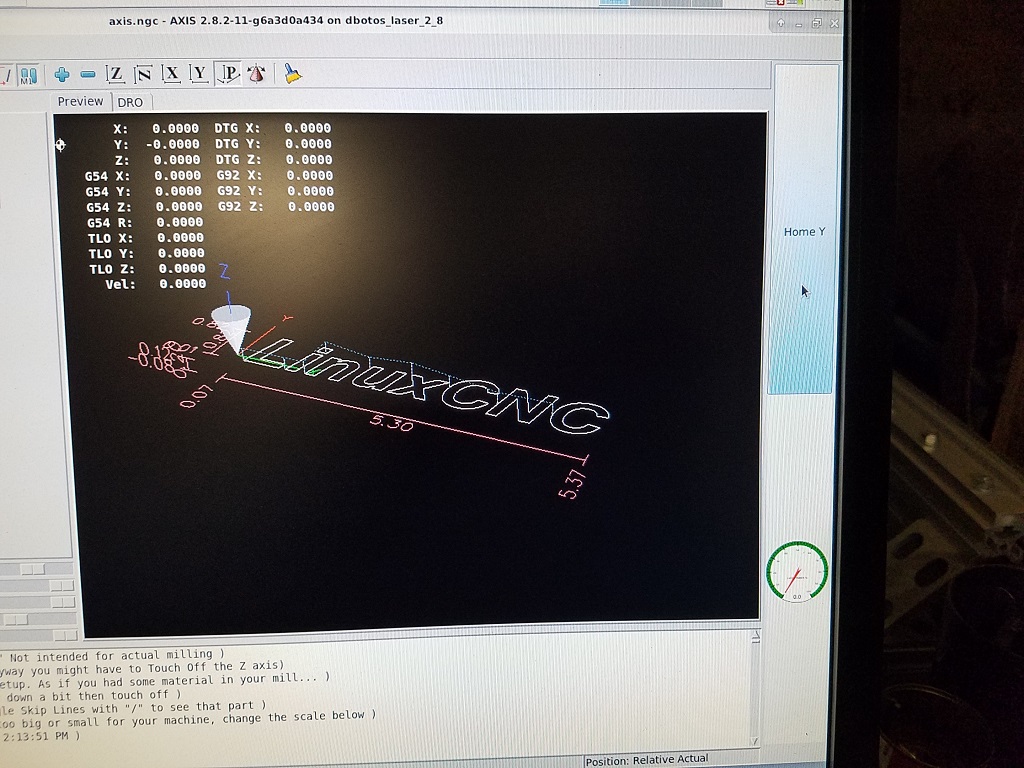

I was able to get LinuxCNC to open without error and show my custom panel. See
this thread
for details.
But now I have new issues. Once I turn physical and software e-stops off and toggle machine power on in the software, I can jog X and Z, but if I try to jog Y, I get the following error:
"Homing is REQUIRED to jog the requested coordinate because joint (1) home_sequence is synchronized (-2)"
If you press the Home Y button (which you can only do at G53 Y0 since you can't jog it anywhere), it will show the little homed icon (see attached pic), so it's not totally non-functional.
If you Home All, then you can jog the Y axis. But, if you press the Home Y button after homing all, it gives the following error:
"must be in joint mode to home"
Any ideas?
Any ideas?
