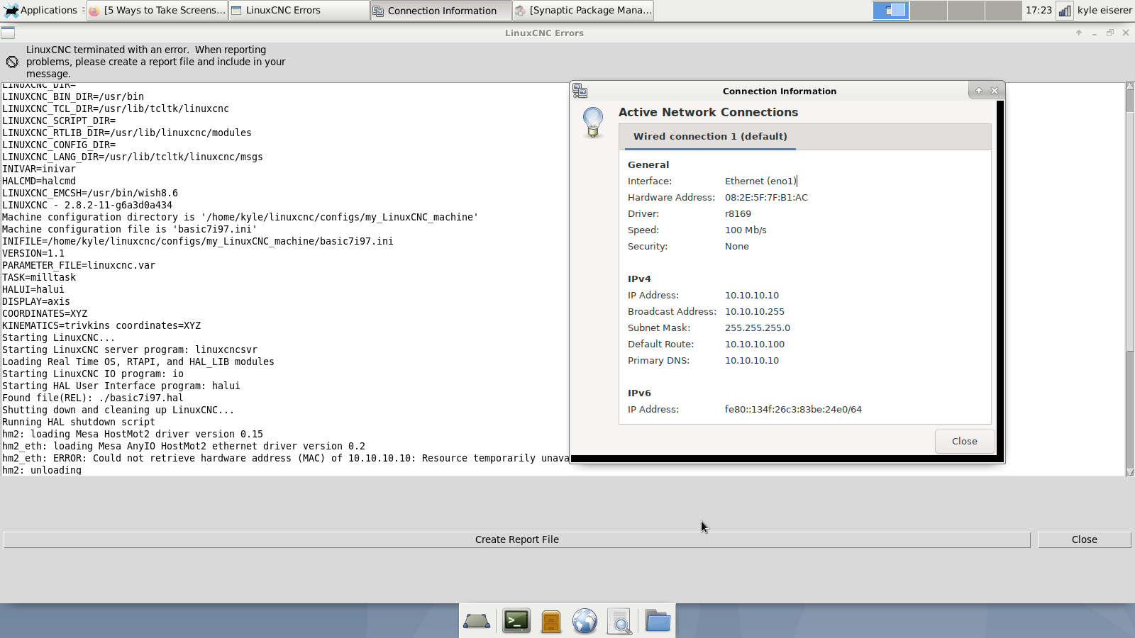

14 Feb 2022 17:24 #234872
by Kylizer
Replied by Kylizer on topic Error Report
- Posts: 18118
- Thank you received: 5336
14 Feb 2022 17:56 #234873
Replied by PCW on topic Error Report
You still have the PC IP address set to 10.10.10.10
The PC's IP address _cannot_ be the same as the 7I76E's address
(10.10.10.10), because all devices on a network must have different
IP addresses. The PC address should be set to say 10.10.10.100.
In addition there should be no DNS or routing setup and IPV6 should
be disabled
be disabled
