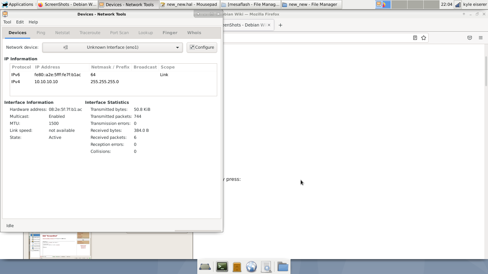

Ok, well I have tried and tried and I still can not get it to work. How do I go about changing the host ip adress and disabling ipv6?

How did you set the address to 10.10.10.10?
Doesn't the "Configure" button open a connection editor?

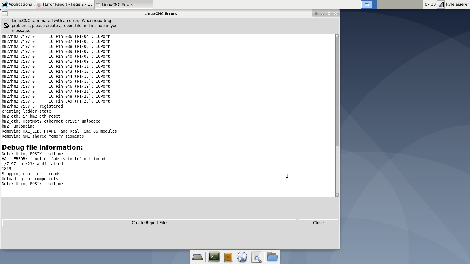

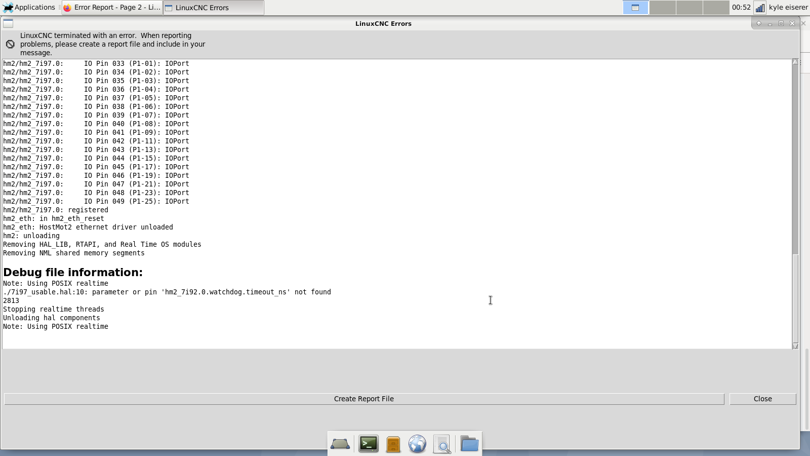

update I finally got it to work but not im getting this

Replied by tommylight on topic Error Report
In the hal file, line 10, there is still a line with 7i92 in it instead of 7i97.
Change that.
Change that.

Ok so i see whats going on here. I delete the file it talked about and another came up. Where would I go to compare the files to know which lines I need to add and which ones I need to subtract?
