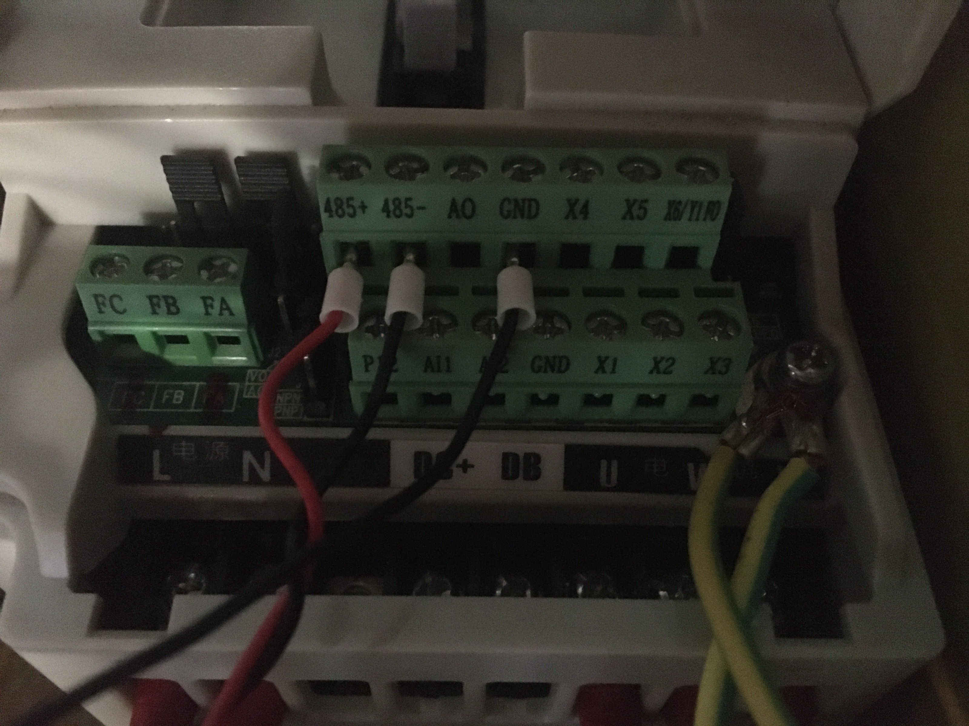

Dongle link, wiring & VFD pinout photo:
Dongle link
A to RS485+
B to RS485-
GND to GND
Tried swapping the A and B connections with no luck.

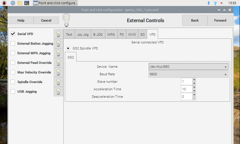

Screenshot of my vfd config in PnCConf:

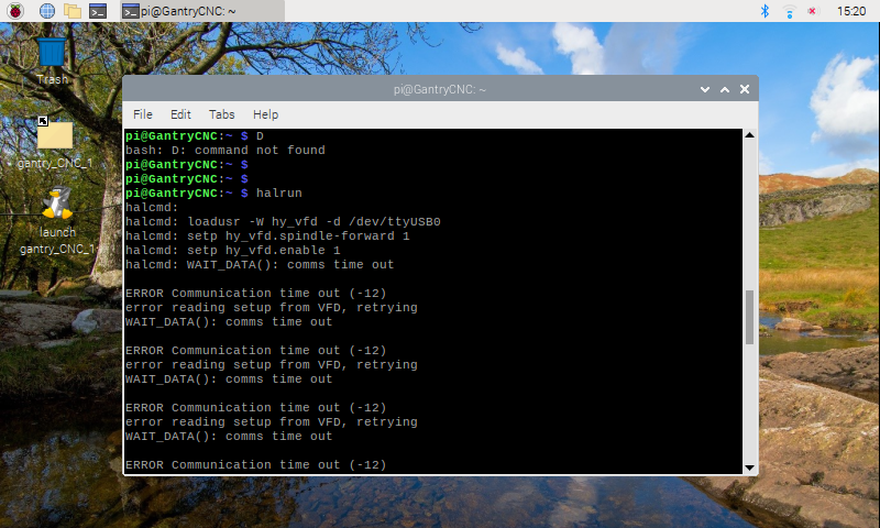

I'm at an odds at this point given I think the dongle is fine given it shows up in windows device manager, PnCConf external controls and via terminal.

I've tried a simple halrun test as well.

Suggest the following, in order...
#1 - check jumper J4; factory default is RS485 comms OFF. See page 8 in manual.
#2 - As cheap as they are, try another dongle. Just because it's showing up as a valid USB device doesn't mean it's working (i.e. output/input to the VFD).

#1
J4 is in the OFF position indeed so it's that's not the issue.

I should've mentioned this earlier but I've tried with the jumper in both the ON and OFF positions to no avail, apologies.

by Hakan
Replied by Hakan on topic V70 stepperonline VFD not responding to RS485 USB not sure what left to try.
Does the VFD actually work with the huan yang driver? I don't think it is real modbus.
Maybe try with the real modbus hal component.

Likely not in hindsight, I hadn't realised spindle talker was written only for huan yang vfds...
How would I go about utilising the real modbus component, what's it's name?

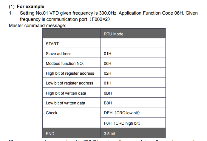

Okay well I've discovered MB2HAL, have modified the example .ini to suit my VFD.
I've now managed to communicate with my VFD, so hurrah, it's not borked!
This example here sets the setting F002 to 0, amusingly cutting off communication understandably.
Setting FIRST_ELEMENT was what defined which setting was changed, no idea what defines the value.
I was trying to set the frequency and in turn the value of the register address seen in the example below. (as I read that was what you set the first element to.)
So the question is, what do I do now?
I've attached my .ini file for reference.
