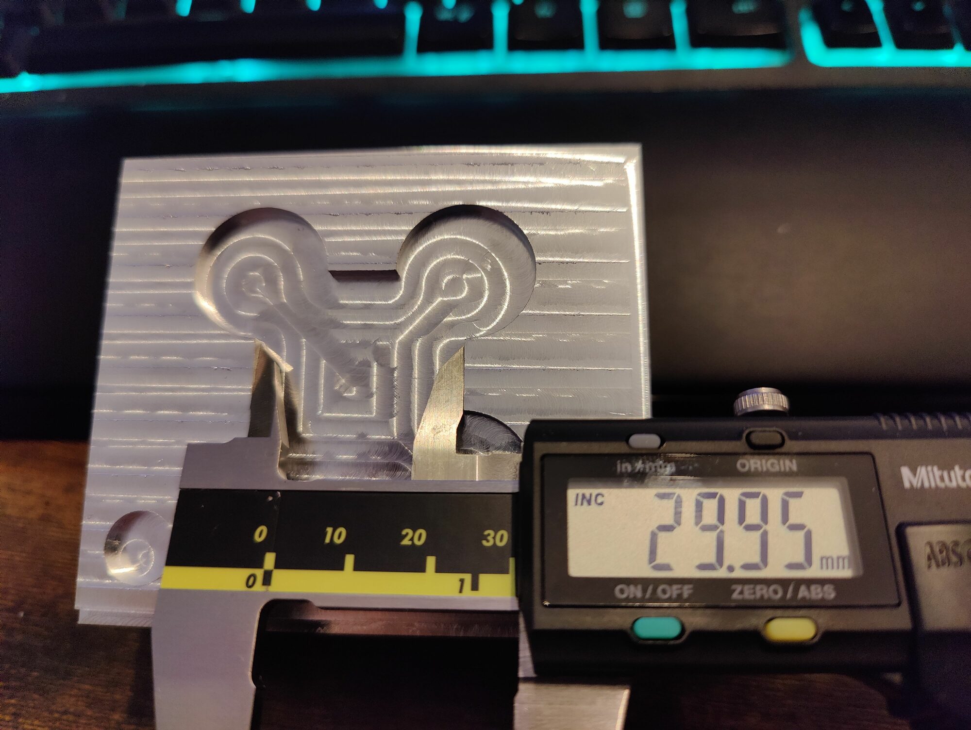

Screenshot of the path in LinuxCNC? What dimensions does it show there?

I have find fix and now is much much better (still have a room for improvements)
But is anyone struggling with this JMC IHSS60 motors please use next settings:
DIRSETUP = 500
DIRHOLD = 500
STEPLEN = 5000
STEPSPACE = 1000
Here is fresh milled image with kaliper measure
Left bottom circle(Fusion: 10mm): 9.91 milled
Big circles(Fusion: 20mm): 19.95
Center square(Fusion: 30mm): 29.95 milled
Depth (Fusion: 3mm): 3.01 milled
I'm very satisfied with result, took me a while to figure it out but works now....
Still need to learn how to do better finishing surface and speeds/feeds
Thanks everyone for looking into and giving me ideas
