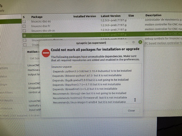

Replied by andypugh on topic 7i96s vfd control
Try following the previous instructions, but get the ,deb from here rather than the slightly outdated link:
buildbot.linuxcnc.org/dists/buster/maste...reempt/binary-amd64/

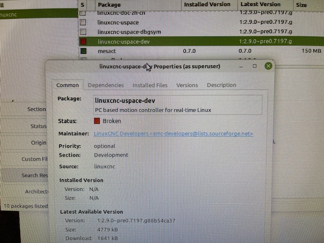

I could not get it work. So I starterd from begining and followed youtube video how to install debian 11 and linuxcnc 2.9.
thank you feral engineer for the video:
I also installed mesaflash and mesact
I still need help how to get spindle work.
I hooked it up my 7i96s card ANALOG SPINDLE INTERFACE to vdf
vdf +10v output to mesa pin 24 (Spindle +)
vdf VI pin to mesa pin 23 (Spindle out)
vdf com/dcm pin to mesa pin 22 (Spindle -)
The problem is, that pin 23 (spindle out is 0v) when i try to run spindle from linuxcnc.
