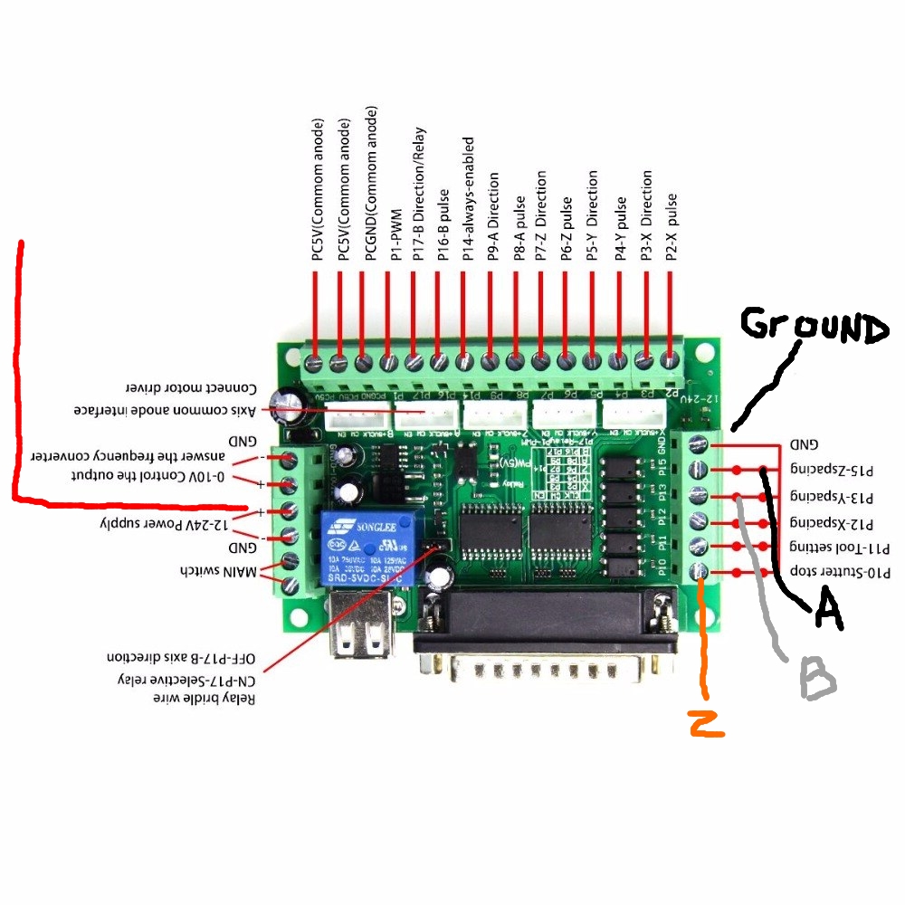

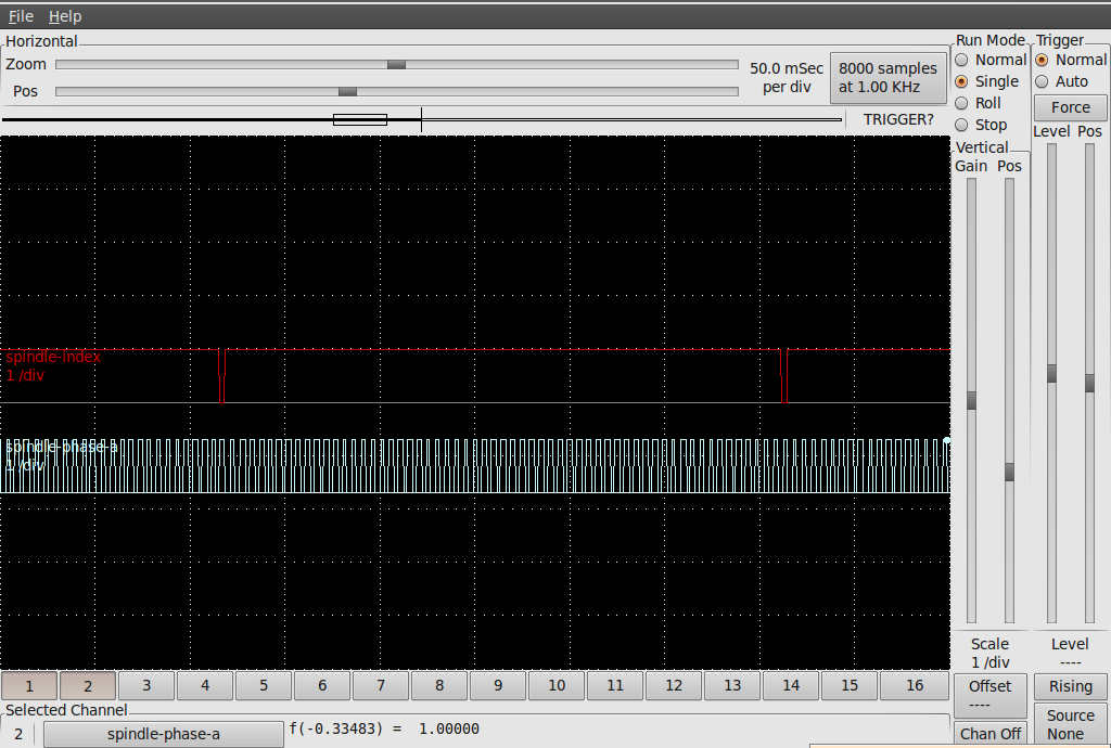

OK bear with me guys, I'm by no means an electronics guy but can solder stuff and in most cases get by with basic understanding of what I'm trying to do.
That said, I found a couple of 800Ohm resistors and soldered them in this configuration.
I did another test cut and I did not changed the spindle rpm and it cut in the same grove as last night, which is the wrong pitch.
In other words, adding resistors did not make a difference.

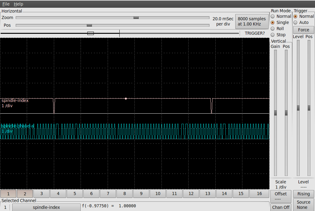

Here is a screenshot of my signals on the hal scope
Here is how I'm connecting it to BOB (minus the B signal)

16 Feb 2023 14:08 #264642
Replied by PCW on topic Need help with lathe threading
I didn't realize you were using that type of BOB
Those should work with NPN outputs without pullups
(as the inputs are pulled up by design)
Can you plot with a bit faster sweep speed so the edges can be counted a bit better
(and perhaps at a higher speed that should result in counting issues)
- Metal Chips
- Posts: 17
16 Feb 2023 14:36 #264645
by Metal Chips
I hope this is what you're asking for
Replied by Metal Chips on topic Need help with lathe threading
OK, this is running the spindle at 400RPMI didn't realize you were using that type of BOB
- JPL
- Posts: 337
- Thank you received: 118
16 Feb 2023 15:13 #264650
by JPL
Replied by JPL on topic Need help with lathe threading
Hummm, something seems to be wrong with phase A. Looks like it is skipping pulses all over the place...
