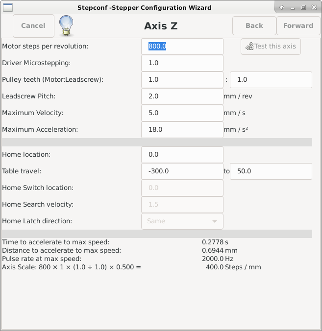

The pitch I'm trying to cut is 1.954 and what I get is 1.5 @200RPM
I just tried adjusting the spindle RPM while it was cutting air and there is no jumping or jerkiness or any weird noises.
Follows the spindle buttery smooth in the range of 0-150RPM
If I go past 150 it seem to follow at the same speed regardless if it's 200 or 400 RPM.
Is it possible that Z is limited in feeding speeds and simply can't keep up with the spindle RPM past 150?
Here is my Z setup
Here is my Z setup

16 Feb 2023 17:34 #264671
Replied by PCW on topic Need help with lathe threading
Yes, that could definitely be it, though I would have expected
a following error if the commanded position was so far ahead
of the actual position.
Are the following error limits set to large values?

- Posts: 18118
- Thank you received: 5336
16 Feb 2023 17:55 #264675
I'm probably wrong, you don't get a following error because
LinuxCNC bounds the geared commanded velocity to 5 mm/sec
even though that will only allow threading a 1.954 pitch thread
at about 153 RPM max...
So if you want to thread faster, you need more Z velocity
- Metal Chips
- Posts: 17
16 Feb 2023 18:04 #264677
by Metal Chips
Replied by Metal Chips on topic Need help with lathe threading
Thank you for your help PCW, I will play velocity numbers and post back tomorrow.
Hopefully with good news, fingers crossed!
